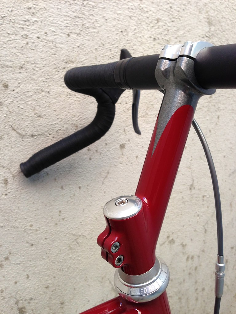

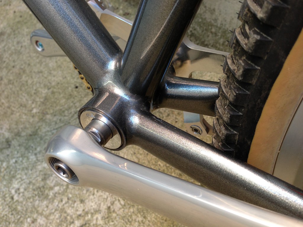

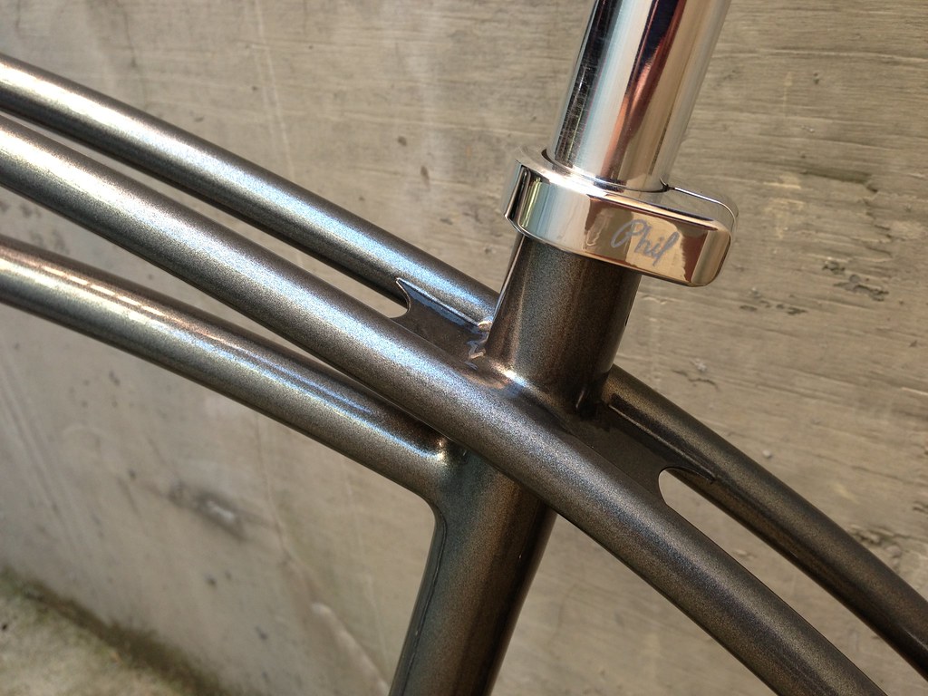

So this is a fun project that JUST got completed. It started about 18 months ago. I'm a big fan/collector of handmade bikes from northern California builders... especially Cunningham, Potts, WTB. But I've always had lots of admiration for Ibis, Salsa and many others.
About a 18-24 months ago, an Ibis Scorcher came up on eBay in a size (large) that I thought might work for me. It was in pretty sweet original condition. Scorchers are kinda whacky bikes -- but there's a great story that goes with them and for Ibis aficionados they're something pretty special. Here's the one I bought: http://www.retrobike.co.uk/forum/viewto ... p;t=201931 It's currently up in August rBoTM (vote early and often!).
It turned out there were 2 big problems with the Scorcher:
- It was too small for me -- I'm 6'5" (1.95m) tall.
- The parts it's built with are pretty much crap. And I mean the original parts spec. Chainline is bad, most of the parts weren't designed for fixed-gear or off-road use. It looks pretty, but really doesn't work very well.
Now, bubbling around in the back of my head is a desire to get a new bike from one of the newer/current generation of NorCal builders. I love them all (Inglis, Sycip, Soulcraft, Falconer, etc.)... but Retrotecs (Inglis'es) had always really captured my imagination. I love the shape/look of my Merin Newsboy... and the Curtis (Inglis) has really taken that concept to a whole new level: http://www.ingliscycles.com/retrotec.php
The idea: Have Curtis make me a new bike that was:
- Functionally a "Scorcher" (single speed, fixed-gear, on/off-road tires). But with rock-solid, top-of-the-line components designed for this use.
- Aesthetically a super pure/special Retrotec. ALL fillet-brazed, and with a sweet Russ Pickett paint job.
The result:
I'll make a few additional posts here highlighting the build spec and some of the more interesting/cool details.

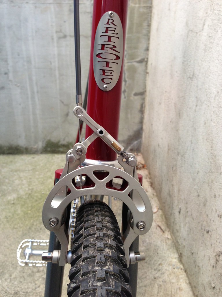

Ermm ... how does the rear brake work? I see a lever on both sides of the handlebar, but only a cable that goes from the left side to the front brake. I don't see any sign of a rear brake.
PostPosted: Thu Aug 22, 2013 3:35 pm
Joined: Thu Jul 07, 2011 1:11 pm
Posts: 2286
It is a fixed gear so no rear brake will be needed. I would imagine that the other lever is there so that the rider has two 'hoods' to rest his hands on while riding.
PostPosted: Thu Aug 22, 2013 3:45 pm
98+ BoTM | BoTM | PoTM Winner
Joined: Tue Mar 10, 2009 2:53 am
Posts: 267
Location: San Rafael, CA, USA
benbonty wrote:
Correct. The right lever has been modified to immobilize the lever blade. It's just for a hand position.

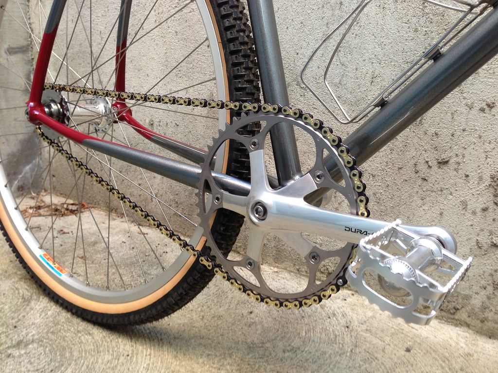

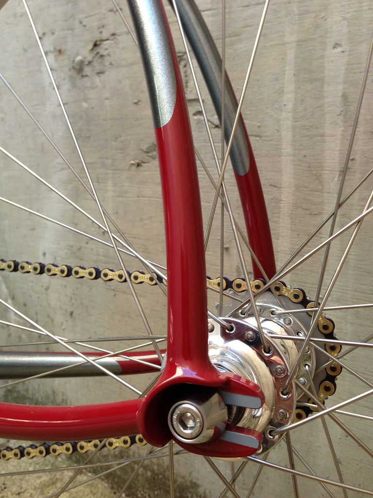

Here's the build specs-
Frame: Retrotec Triple “Scorcher” (Fillet Brazed including BB)
Fork: Retrotec Lugged with Pacenti Paris-Brest crown, Cunningham steering limiter
Headset: Chris King NoThreadSet (Old-Cup, No Logo), Cunningham tapered spacer
Stem: Retrotec Custom (threadless-style)
Handlebar: Salsa Woodchipper 46cm wide, 31.8mm clamp
Tape: Velox Tressostar 90 Black Cloth with Grab-On underlays, Velox bar plugs
Brake: Cunningham LeverLink w/Cunningham Bridge (F)
Brake Pads: Kool-Stop Thinline Salmon
Brake Levers: Shimano Dura-Ace BL-7402 (Cunningham-modified)
Cog: Phil Wood Fixed 1/8” 21t
Chain: Izumi Model-V Super Toughness 1/2” x 1/8” NJS
Cranks: Shimano Dura-Ace FC-7600 175mm NJS
Chainring: Shimano Dura-Ace FC-7710 53t NJS
Bottom Bracket: Phil Wood 126mm Campy/ISO Stainless Axle
with Phil Wood Cups, Crank Bolts, Mud Guards
Pedals: MKS BM-7 (placeholder setup)
Hub Skewers: Phil Wood (bolts)
Rims: Velocity Synergy Silver 700cx32h Machined (F), 36h Non-Machined (R)
Hubs: Phil Wood Kiss-Off Silver 32h (F), 36h Fixed-only (R)
Nipples/Spokes: DT
Tires: Bruce Gordon Rock‘n’Road 700x43c
Saddle: Cinelli Unicanitor “Track”
Seatpost: Paul Components Tall & Handsome 27.2mm Polished
Seatpost QR: Phil Wood 30.0mm Silver
Bottle Cage(s): Cunningham/Nitto “XL”
Pump: Zefal Solibloc, seatpost/internal (Cunningham-modified)
