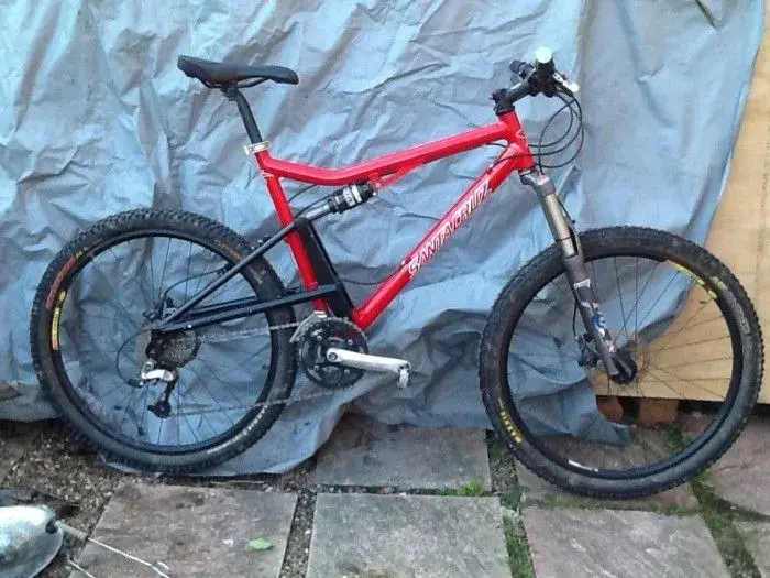

heres how it started... (not my pic)
the picture really doesnt do how bad a condition the paint work was in... it was AWFUL! really flaky and shoddy stickers peeling off..
and the second i unwrapped it.. the shock leaked oil EVERYWHERE!
I had the frame soda blasted.. but due to the AWFUL blue paint on the rear triangle it was going to be too many £££ to get that blasted off too.. so i did that myself with some paint stripper..
took soooooooo long to fully clean up..
Then i hand polished the rear... and got the front triangle powder coated in satin black..
Brand new bearing / axle kit as they where shot too..
the seat stay brace was pretty knackered as well... so i made a new one of those out of a sheet of Aluminium i had..
i originally built up the bike for me to ride... with some Z1's an 80mm stem and triple chainrings up front (and it had an RP23 on it at that time)
blurriest picture ever!
but after my other half rode it... it quickly became her bike..! as it was like.. 'riding on a cloud' compared to her old Stumpjumper Hardtail!
i rode it a couple more times..
Test ride with a Marzocchi Roco Shock.. (didnt work.. damping all wrong!)
Test ride in the snow with the 80mm Bombers from my Rockhopper.. (works really well with 80mm forks!)
and here it is being ridden in its current guise..
headtube badge...!
The fork is an 80mm 1996 Judy DH.. but only has internals in one leg.. a Medium Kronos spring and a New Judy Damping cartridge ..
the other leg is empty apart from a cutdown dummy leg (to save weight) that just acts as a top out bumper on that side
works really well for the light rider!
The X-Fusion shock works really well with the frame too as it has a quite light compression damping tune, which is essential on this frame due to its low leverage ratio.. and the air spring is great too as it allows the low spring weight required for a lighter rider.. as well as being adjustable should i ever want to put the Z1's and longer stem back on and ride it myself!

it does actually have frame graphics..
theyre just a bit stealth and dont show up in the photos as theyre gloss black! looks quite nice in person.. but tricky to photograph..
the original shock was too far gone to repair in my opinion.. the shock shaft was really worn.. and the bushing inside the shock head was gone.. and i dont think id have been able to get the right seals either! :LOL: and on top of all that i wouldnt have been able to get a light enough weight spring for my partner without spending mega bucks on something titanium! :LOL:
the Z1's i had on it rode really nice on the bike.. felt just right to me..!
the only reason its got 80mm forks on it now really is to give a lower standover height (and softer forks) at the front
when i ride i next it'll be getting the Z1's put back on! ive even seen pictures of people using 130mm forks on them too and they don't look too choppery..
by bushings.. do you mean the shock mount kit?
if so... i got mine made at http://j-techsuspension.co.uk
but be careful.. the front mount on mine had an ID of 8mm and the rear 6mm (think it was that way round anyway..!)
i got a new main axle too from stif from a Juliana pro pack.. and just happened to have some of the right sized bearings to fit from somewhere! as the juliana pro pack ones where too small a diameter..
I run 130 mm forks on my large heckler but i,m 6foot and 200 lbs might have problems with a smaller and lighter rider only changed head angle 1.5 deg
