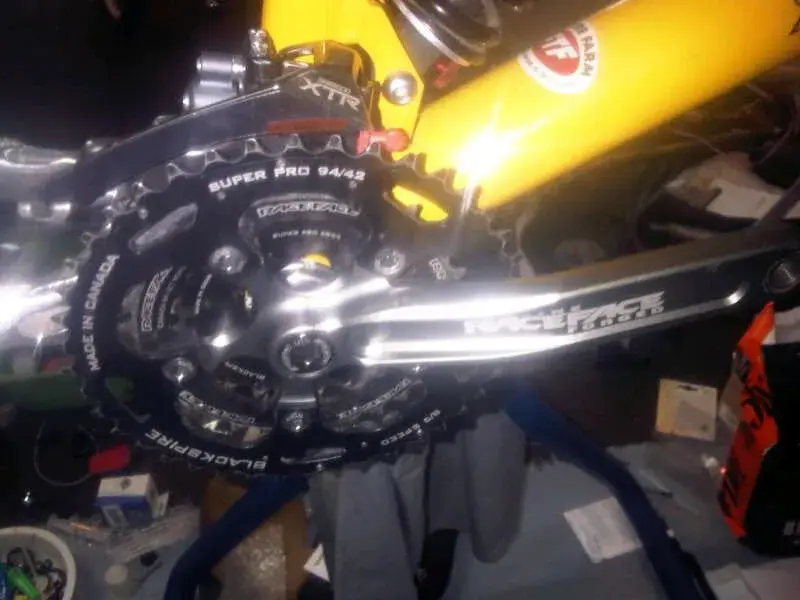

File comment: Cranks fitted

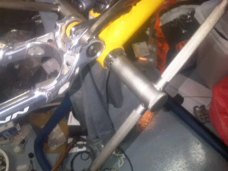

File comment: Chasing and facing the BB threads

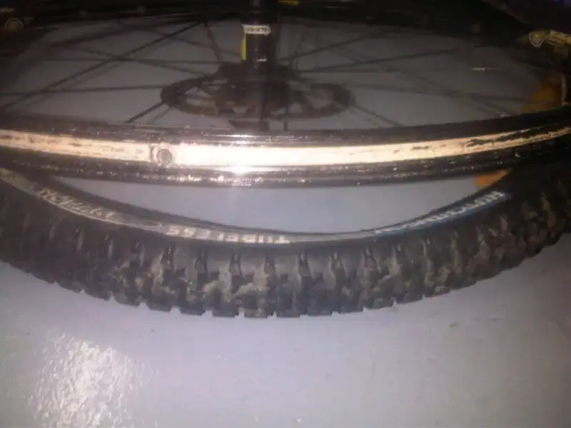

The Stans Notubes Tubeless sealant dried out and formed a "rim tape" on my Crossrocs:
