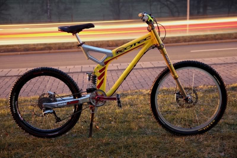

I don't have any digital pics of my old bike (that had to be retired after losing a battle with a tree) so here is a nice example I found on the web of a MkI Rotec Pro DH bike similar to mine:

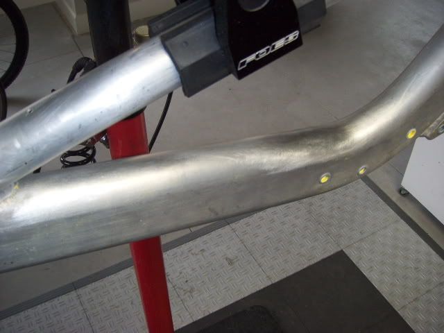

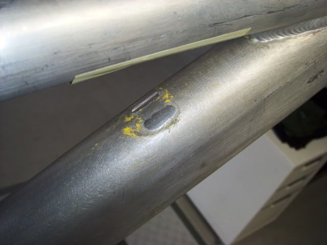

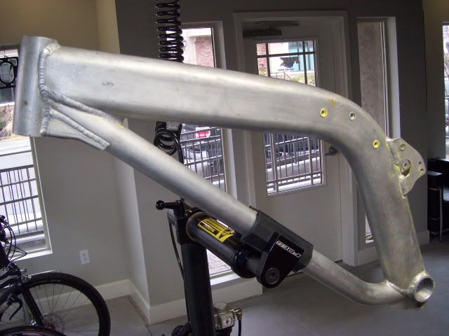

I started by prepping the main frame I got from Sullivan.

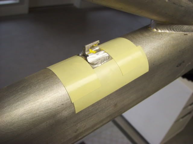

Since I won't ever run a front derailleur, I shaved off the housing stops.
Frame with one stop already removed (under the top tube)
Removing second stop:
Both stops removed:

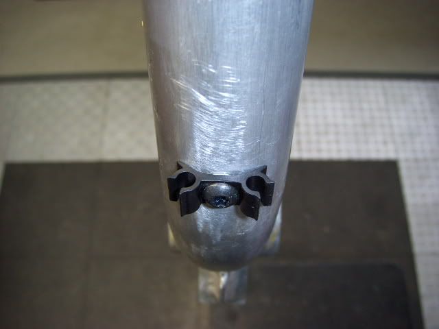

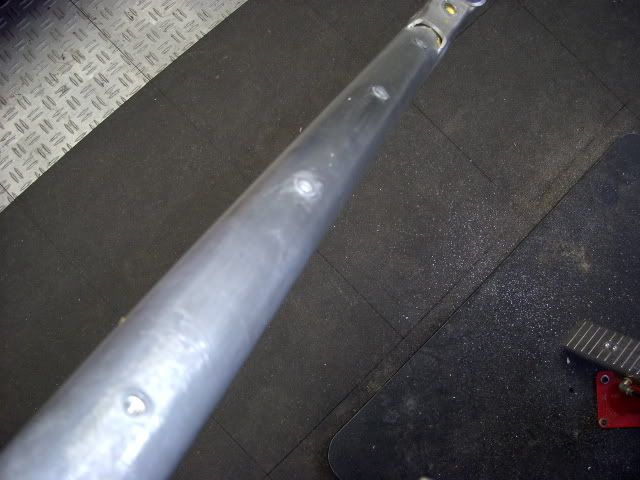

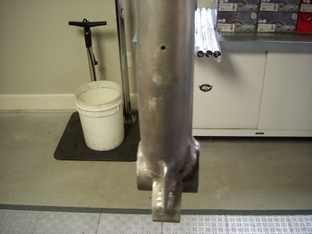

The original bikes had continuous housing guides riveted to the down tube. The frame I received had no guides, only the holes:
I drilled out the holes and installed rivnuts:
Now I can bolt on these clips I fortunately had laying around the shop:

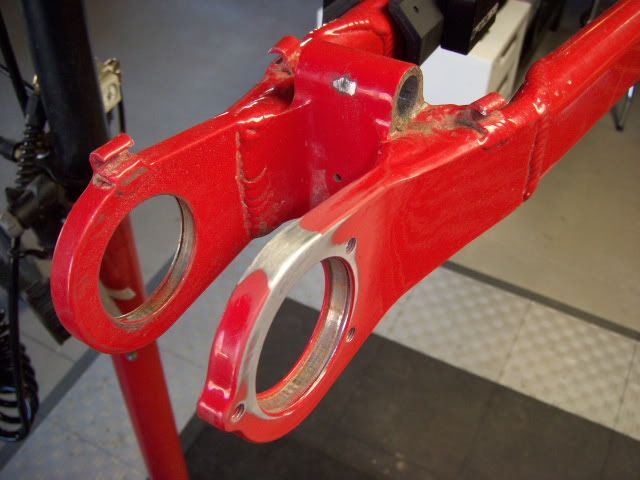

Next I prepped the swingarm by filing some chain rub smooth and removing one of the housing guides that was smashed to oblivion:
The main frame has been sent to Spectrum Powderworks in Colorado and the other pieces just got back from chemical stripping:
I'm dropping those off with the metal polisher tomorrow to have them polished before they are anodized.
