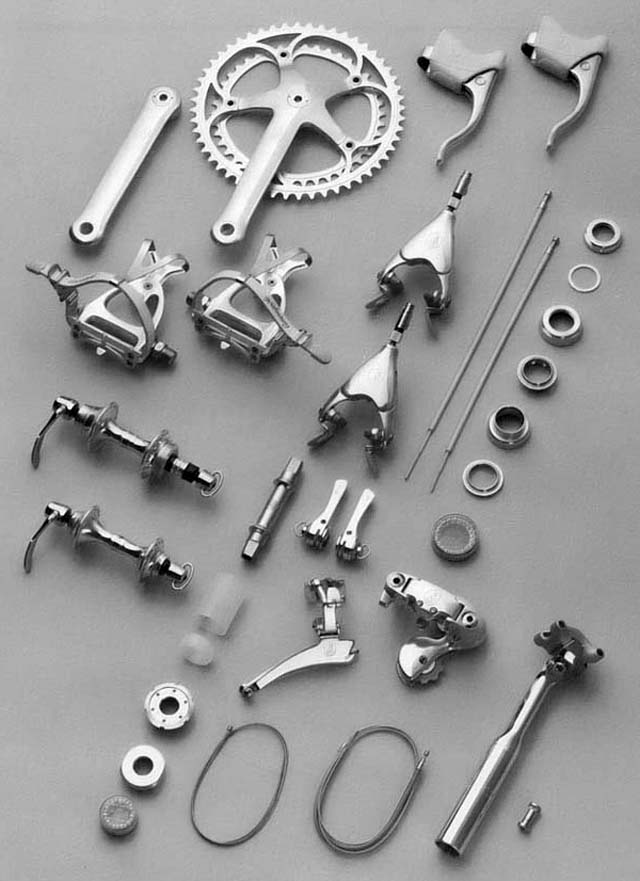

If like me you're constantly frustrated by sellers trying to pass Campagnolo items off as C-Record then I figured it might be useful to attempt to state a few facts about what actually are genuine C-Record (Corsa Record) parts.
I am still a relative novice to this myself so please feel free to correct me if I'm wrong.
I understand C-Record to be Record Groupset items produced between 1985 and 1990.
Correct C-Record items include
Crankset - Gen 1 (engraved shield) and Gen 2 (painted shield) 4-arm spider with hidden 5th bolt. Despite being used with early 1980's 8sp Ergo groups this remained a C-Record item.
Headset - Generic Chorus/Record square nut with holes in upper race.
Brake levers - Gen 1 (white hood Cobalto style) and Gen 2 (Aero with Power Grade adjustment)
Brake calipers - SR-style Cobalto with italic script and of course Deltas
Seatpost - Thinner more minimalist single bolt design without flat sides. I've seen these with and without shield and were used with later Record and Chorus groupsets.
Hubs - C-Record was never 8sp cassette, strictly 7 (and possibly 8) spd freewheel. Low and High Flange (Sherifs Star) Hubs had removable central oil port clip.
Shifters - Strictly DT shifters only, friction and Syncro. There were many designs but I suspect it's fair to say any DT shifters with shields on their blades are C-Record though i know these were also seen on Chorus and Athena equipped bikes.
Front derailleur - There was only one, the gloriously over-engineered and slightly larger unit with the dovetail pivot. came in the band-on version with the 2-point flexible band plus a braze-on version.
Rear derailleur - Gen 1 (no hole in lower cage) and Gen 2 (with hole) i.e.the only Campagnolo rear derailleurs which displayed a shield instead of text though the later 1992 version featured text in an attempt to make it part of the pre-Ergo record group of the year.
With the exception of some C-Record specific pedals, rims, clips etc I think it's fair to say that if items aren't any of the above then they just aint C-Record.
Items that are NOT C-Record based on frequent misconceptions.
Crankset - Chorus, Croce d'Aune, Athena
Headset - Generic Chorus/Record/Athena square nut without holes in upper race.
Brake levers - Athena/Chorus/Record aero levers without Power Grade adjustment.
Brake calipers - Monoplanars, Athena D100 central pivot, gen 2 Super Record (italic script) and all later dual-pivot
Seatpost - The generic flat-sided record/Athena/Chorus unit shield or no shield.
Hubs - Any 8sp cassette hub and any hub without the removable oil port clip plus Chorus & CDA freewheel hubs which also have the oil port.
Shifters - All Ergos plus any shifter that has the text 'Campagnolo'
Front derailleur - Anything that doesn't have the massive dovetail main pivot.
Rear derailleur - Well, all really, there was only the one C-Record design.

A good idea, but you have to be accurate. For example, if we just consider the rear derailleur; the first generation (I bought one new) has an engraved shield on the body and no jockey wheel housing cutaways.
The second generation does not have the engraved shield it has a painted Campagnolo text on the body and a semi circular cutaway on the outer lower jockey wheel housing.

According to the 1988 catalogue there is a difference between the Record and Chorus headsets. The parts are all the same including the 3/16" bearings except apparently the lower cup that fits into the head tube. The Record part number is 1131059 while the Chorus (also supplied with CdA) is 1131049 unless that is a typo in the catalogue - I don't think so because the overall part codes are A0D0 (Record) and C0D0 (Chorus). I don't know how to tell the difference though :?

I share your frustration, but am curious as to why you consider Corsa Record to end at 1990?
Major changes (dual pivot brakes, Ergo shifters) didn't occur until 1992 and even then it is clearly of the same family.
For me, the C-Record era lasted until 1994, with a major overhaul for 1995.
I agree that VB needs to be treated with caution, but (with all due respect) isn't this thread also UGC?
A useful exercise certainly, but the catalogues are the only source I implicitly trust.

I found a source on the web with all of the catalogues (I'll try to remember what it was) when I was researching my latest C-record equipped bike. Its a bit more complex than this. For example, in 1987, there were 4 different styles of pedal.
