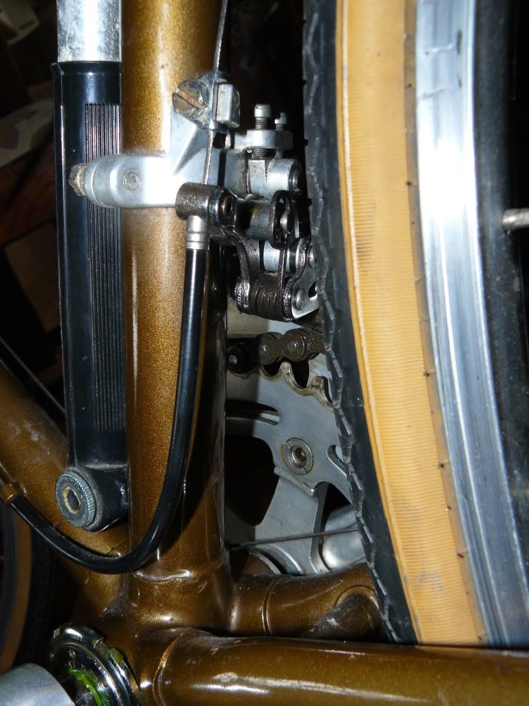

This may help - an earlier Suntour reverse action mech but looks similar in the mechanics.
It's a bit hard to get your head round but the movement is driven by the cable sleeve pushing the lower lever. Because the cable end is fixed to an immoveable part of the derailleur the system works by taking up the slack in the loop of cable within the sleeve (the loop is the only place where the effective length of the cable can alter). The bottom end of the sleeve rests in the cable stop so the other end of the sleeve effectively pushes the lower cable clamp on the mechanism.
There's nothing missing but you do need a stop on the frame - visible bottom left in the picture of my mates Carlton Corsair that I renovated.

I'd have been quicker but I had to take the pic and upload it!
