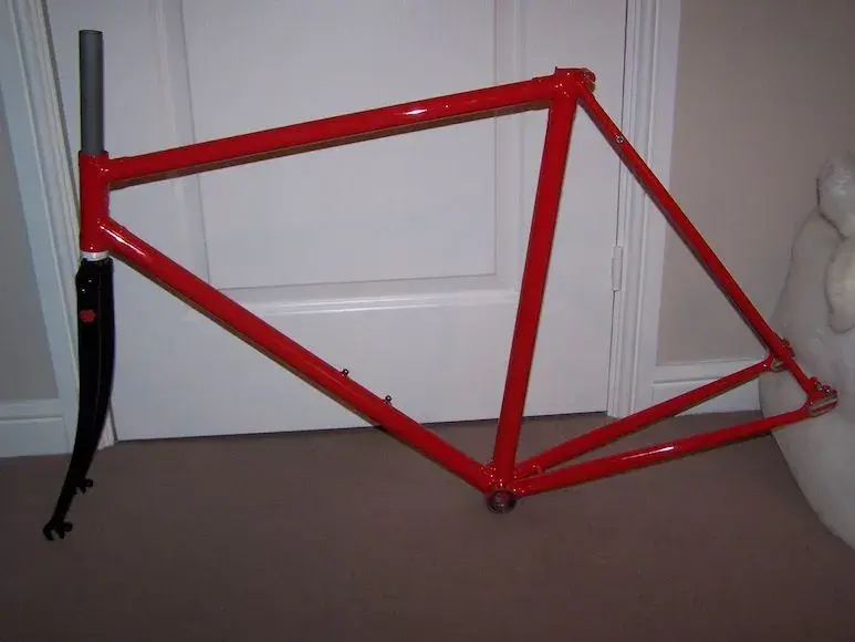

has anyone done it?
Yup
this is Scarlett, built for Mr Evilgoat

Posts: 3280
Looks good! any advice?

Everything I have ever read about frame building says the novice usually screws up the first couple of frames. So the advice goes — don't use expensive tubing for your first frames.
Pondlife — your frame look gorgeous! How many have you built? [/b]
