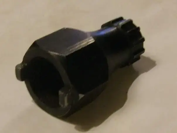

I've got one of these you can have for £4 posted (First Class Packet) - payment via Paypal.
However, you need to know that those things could be a nightmare to remove - the Regina Extra was the worst things ever created when it came to getting it off the wheel! The notched fitting into which the tool fits disintegrates with ease, and the tool therefore needs to be clamped very securely onto the hub axle (QR skewer, e.g.). These were the freewheels that resulted in manufacturers moving to splined tools...
Even if you are really careful it's still possible to destroy the dogs with the tool - I've seen that raised section peeled right back until there's nothing left! If you do this the freewheel is obviously finished anyway. My suggestion would therefore be that you dismantle the freewheel:
Knock the cover plate off - the two holes turn clockwise to undo (LH thread)
Holding the freewheel over a large bowl or similar pull the bit with the sprockets on it off of the wheel. Tiny bearings will shower everywhere (hopefully into the bowl...), and two pawls plus their leaf springs will probably also fall out.
The fitting for the pawls can be clamped into a vice; turn the wheel to remove the remaining bit of the freewheel.
Personally, I'd then replace the freewheel with a modern Shimano or similar.
However, it's perfectly possible to rebuild the freewheel. It's not an easy job, though. Fix the bearings in place with grease (not too much, or your freewheel will work both ways...), place the pawls / springs in place and hold them flush by wrapping cotton thread right around the freewheel boss and over the pawls, and replace the bit with the sprockets on it. It's much easier to explain this than it is to do it; you need about seven or eight pairs of hands and considerable precision to avoid another display of exploding balls. :x

File comment: Regina freewheel remover (old Shimano UG the other end, I think).

Yes, the old two prong jobs are a real PITA, I've got a 15" adjustable spanner for such occasions enables me to get plenty of purchase.
I stand over the wheel so can push down whilst keeping the tool straight using the QR lever which you screw on quite tight to hold it in place(remove the small coiled springs)
When you get it going just a small bit unscrew the QR a little then it should be plain sailing after that.
I always always put on copper grease on the threads so no chance of it ever sticking again.

I am sure that I used an alternative approach. Clamp in the vice a bit of flat bar that fits the slots well. I have used big flat headset spanners doubled. Plenty of length means that even if everything slides, nothing falls out. Whilst maintaining some downward pressure turn the rim anti clockwise. Much easier than using the correct tool and a spanner

Well I am either a naturally talented cycle mechanic or very very lucky. I got the tool from Simon and the freewheel came straight off. No problem. I have to say that the bike it was off has been stored for over 20 years, and must have been cared for in the past as everything came apart with ease. Thanks for all your help everyone.
