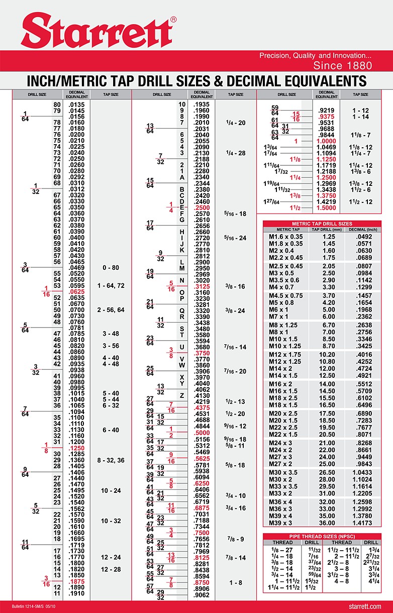

Next up was fixing the very annoying hose that kept loosening. This modification required drilling the hose port using a "Q" drill so it could be tapped to 1/8 NPT tapered pipe threads so it would accept a standard 1/8" NPT to 1/4" hose barb, as the supplied SKS fitting won't accept standard 1/4" air hose :facepalm: . The hose used was 1/4" 300 PSI rated industrial air hose, the fitting is a SSP 300 PSI rated hose barb, and the hose clamps are Oetiker.
