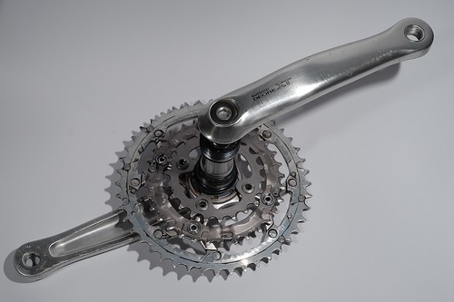

I need to replace the two inner rings on my XTR M900 chain set
Will any reasonable Shimano fit or do I need 'quirkey' rings?
Thanks in advance,
Floss
it's a bit hard finding the real original xtr rings for m900 now, i put TA rings on mine and middleburn on another.
110 bcd for the middle and top and 74bcd for the inner ring, sizes are a preference, i run 26/36/46

900s have a normal, 5-bolt spider/ chainrings, not a splined interface.
New "compact" roadie cranks are now using the same 110mm bolt spacing as the old (pre-micro-drive) "ATB" pattern. Not sure if the roadie rings come in any useful sizes, though.

Any normal ring that fit the bolt diameter will work.
I usually use 24/36/48 tooth ;)
They call it ATB fit.
Middleburn slickshift (or slickshift hardcoat) to keep the pinned style shifting
Come individually or as a set
Set here
