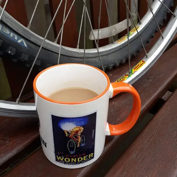

Putting the 1992 Marin Eldridge Grade back together and starting from the floor..hence wheels. The rims have sat in somebody's damp garage for a long time and are best described as dull, so dull they suck the light out of the surrounding county, yes that dull!
A clean with Nutz de-greaser has improved things, next was going to be an abrasive pad and then perhaps some metal cleaner (Brasso or something). Not looking for perfection, just nicely clean.
Any suggestions welcome, or any "NO DON'T DO IT!" pearls of wisdom.
Cheers
Janners.
Post looked lonely without a photo, so here are the rims and my coffee.
