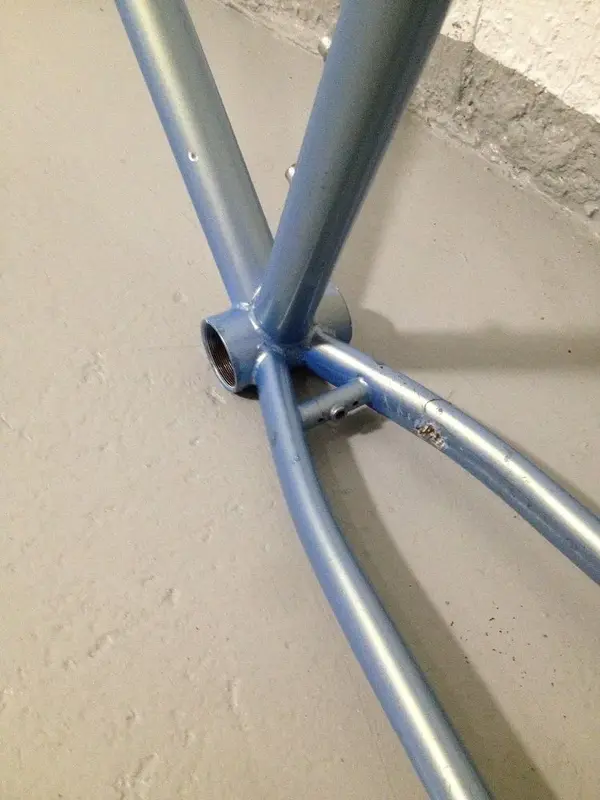

Here's a summary of the quest so far. Pls see page 6 - the new pics of the totally stripped frame.
Distinctive (or not) details:
(1) Seat tube top - is concave, curved in.
(2) Rear brake cable routing - brazed-on noodle on the seat tube.
(3) Seat post binder bolt - is behind the seat tube.
(4) Top mounted cable routing - the shifter cables and the rear brake cable are routed along the top of the top tube.
(5) Head tube - the reinforcement rings.
(6) Rear derailleur cable braze guides - are under the seat stay.
(7) Ritchey rear dropouts - incl flat (vs round) seat stay and chain stay ends
Measurements:
- Weight (approx): 1.886 kg
- Steerer: 1 1/8 inch
- Seatpost (approx): 26.6 mm
- BB (British): 68 mm
- Dropout spacing: 135 mm
- Top Tube (approx): 590 mm (c-c); 615 mm (effective); 28.6 mm (diameter out)
- Seat Tube (approx): 435 mm (c-t); 390 mm (c-c); 28.6 mm (diameter out)
- Head Tube (approx): 110 mm; 36.5 mm (diameter out)
- Down Tube (approx): 32 mm (diameter out)
- Chainstay (approx): 420 mm
- Reach (approx): 460 mm
Serial Number: B99XXXX (B plus 6 digits)
Other (Ir)Relevancies:
- Came equipped with a threaded 1 1/8 inch triple butted (TB) rigid Kona Project 2 (P2) fork.
- Originally from Germany.
Close matches so far:
- Many Scott mid-90s models.
- Biria MX700, but round seat stay and chain stay ends and the 27.2 mm seatpost.
I will now extend the quest to other forums as well.

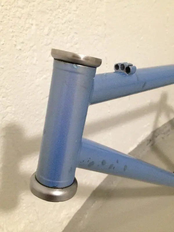

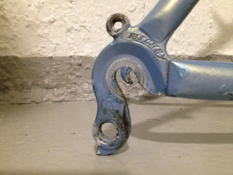

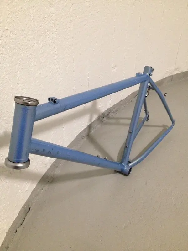

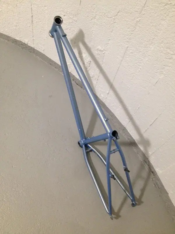

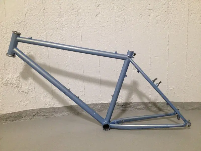

The original first post of the thread "ID 2 kg mid 90s steel frame - with TB P2 but not Kona?":
Hi everyone,
I acquired this steel frame awhile ago, just to get the threaded 1 1/8 inch Kona Project 2 rigid fork it came equipped with to another build and let the frame go. Then I noticed the "TB" (triple butted; later measured 834 g, incl a bolt) stamp on the steerer, and that aroused my interest in the frame too - but is it any good?
Distinctive (or not) details - please also find some pics attached:
(1) Ritchey dropouts: doesn't mean much as such, lots of builders used them. No other markings, serial numbers, etc.; maybe under the paint, but not available now;
(2) Top mounted cable routing: the shifter cables and the rear brake cable are routed along the top of the top tube (a racing feature maybe - racers can carry their bikes more comfortably...?);
(3) Seat tube end cut: is curved, something you see with seat lugs:
(4) Seat post binder bolt: is behind the seat tube (cf mid 90s Specializeds; vs mid-90s Konas mainly have them on the other side of the tube (right?);
(5) Brake cable routing brazed-on noodle on the seat tube.
(6) Rear derailleur cable braze guides: are under the seat stay.
(7) Head tube: the reinforcement rings.
Close but no cigar:
- Trek 830/850 1994-96: (2)/(3)/(4) are about right, but what about (1) and (5)? (6) & (7) not there...
- Gary Fisher Hoo Koo E Koo and Aquila 1993-94: just about everything right (incl "brake snake rear cable guide") except seat post size (27.2 mm)...
Measurements:
- Weight: 2.044 kg/ 4.321 lbs (incl the headset cups and the bottle cage bolts)
- Seatpost: 26.6 mm
- Top Tube: 590 mm (c-c); 615 mm (effective); 28.8 mm (diameter out)
- Seat Tube: 435 mm (c-t); 390 mm (c-c); 28.6 mm (diameter out)
- Head Tube: 110 mm; 36.5 mm (diameter out)
- Down Tube: 32 mm (diameter out)
- Chainstay: 420 mm
- Reach: 460 mm
If anyone knows what this frame is and could help me identify it, I would be most grateful. All input appreciated, any ideas or suggestions are most welcome.
Cheers

The devil is in the detail. I agree, the overall look & feel is kona-ish, yes, but the details are not there - at least, all of them in one go. E.g. I suppose very early Konas have brazed-on noodles, but top mounted routings for all three cables...? The Kona/Ritchey collab...? Etc.
However, when you look at the early Konas (e.g. '89 Explosif) and see the similarities, my mid-90s estimation can be misleading; the frame can be older - or not...
