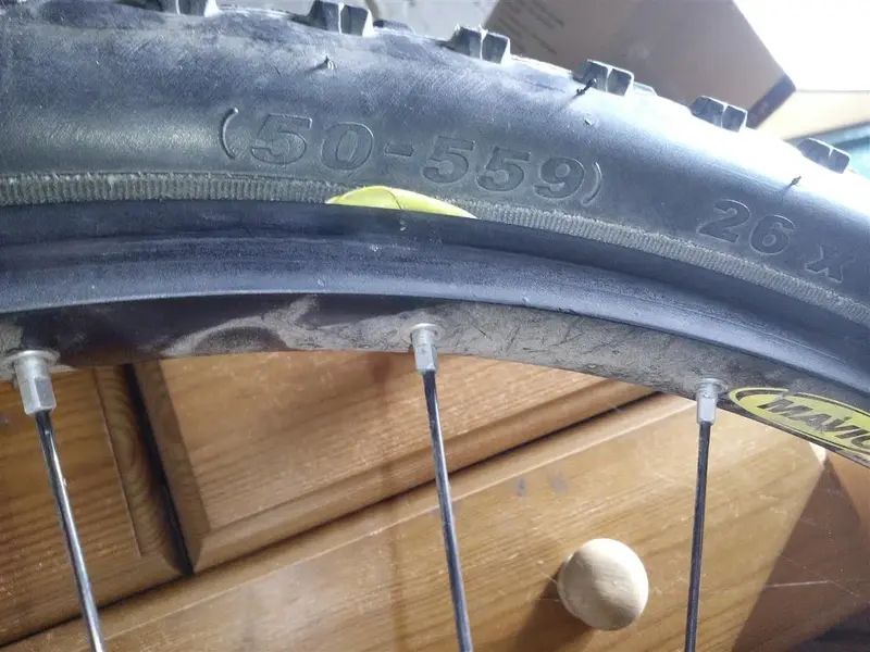

Unexplained brake rub on 1st gen Crossmax
Fatal Swan
....now explained, 3 rides later :facepalm: A bit ashamed it took me that time to figure it out. Not sure how this happened but I've always hated those plastic Mavic rim tapes!

Anyway back to topic, presumably this was bad fitting as opposed to rim tape moving?
And if you had disc brakes this wouldnt be an issue.
The offending plastic rim tape (it was Michelin branded) has now gone. No idea what caused it - as far as I know that stuff is factory fitted and can't really be removed and reinstalled. Can't figure out how it got burped out of the rim!
It's been replaced with good old Scotch strapping tape (https://www.amazon.com/Scotch-Reinforce ... 00004Z4BC/) - one of a handful of weight weenie-approved rim tape options (3-4g a layer, I do 2 layers for safety), and probably the cheapest too!
