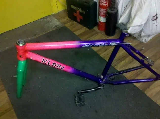

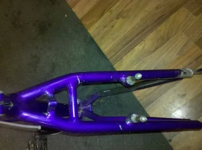

So the story is a mate of mine got a klein Attitude but the frame is badly cracked . So what we would like to do is remove the forks, stem and Bottom bracket and add them to a new frame so we need to remove and replace the forks on to a new frame.
So the question is should we hammer the fork out or is there another way which might do less damage to the fork?

That's a nasty crack in the frame :?

and it's a storck model? Jeeze!! I've got the official manual if it's not already on here....

Yep 1st crack was near the bottom and welded then a second crack on top of rear stay...
Was hoping there would be a tool or a detailed guide to remove these forks.. looks like a press or rubber mallet might be the way forward
