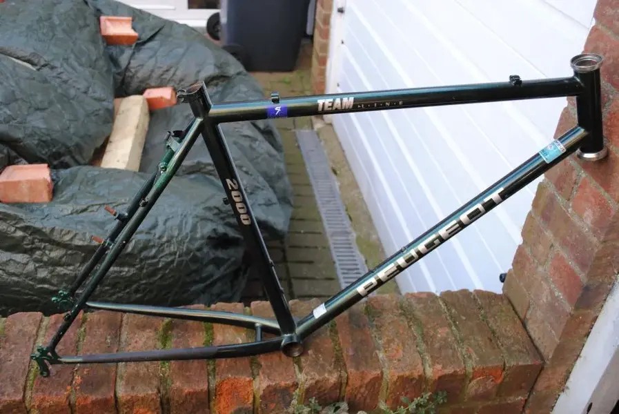

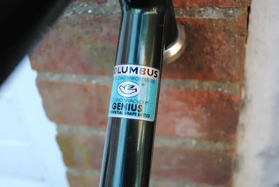

Bought a Peugeot 'Team Line 2000' MTB frame at a cycle jumble on Saturday and its made of Columbus Genius nivacrom.
I'm not up on my Columbus and just wondered where it sat in the hierarchy.
The frame was £10, no forks, canti cable guides.
I am quite sure the particular frame can be found in Gallery 2 under 'Peugeot'
Very phukking agreeable ironwork indeed. At £10 you are exceeding the jamminess of a visible-from-space Robertsons Strawberry Jam factory.
It uses differentially shaped butts ( big word translation: the butts are shaped to the areas of highest stress ) and these are therefore shorter than normal. It was a strictly for tig welding tubeset. Bloody light, really tough.

I think it appeared because the Saracen blue & white was too damn small.
Lucky find eh? Same jumble had a Hetchins in original paint for £40...
Pics: headset cups are in loose as I was sizing up for some triple butted forks but they were too short.

Nivacrom was Columbus' top grade of steel.
Genius was an extra lightened version, optimised for TIG welding.
It's very nice - but so thin that a dent will possibly write off your frame. Have seen a couple of insurance cases on Genius road frames that had stuff fall on top of them - an the results weren't pretty.
