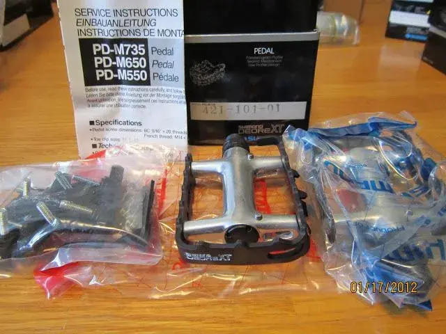

Seems strange they would be riveted on :? anyway, the service manual is on the XT service instruction leaflet if you can find one of those.
