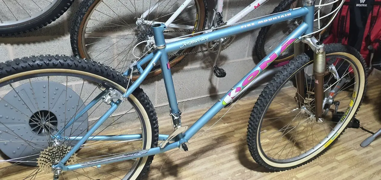

Your frame is a 1994 owing to the lack of a Triangle cut-out in the dropouts, and produced towards the very end of 1993.

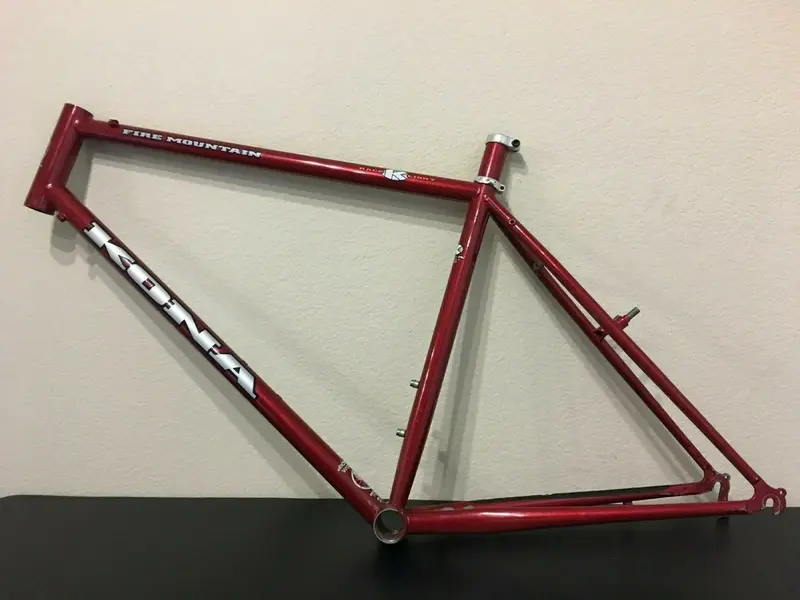

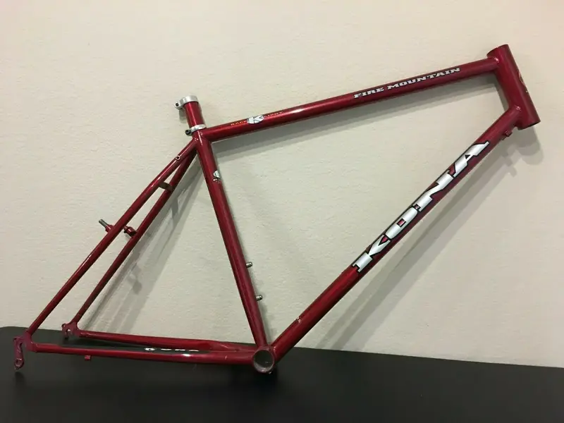

See 1993 Fire Mountain below:

The vernier said 26.65 inside the seat tube. But they do seem to be a little out sometimes.

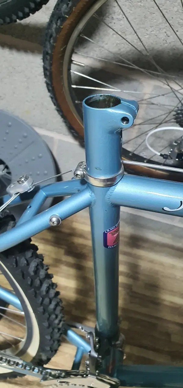

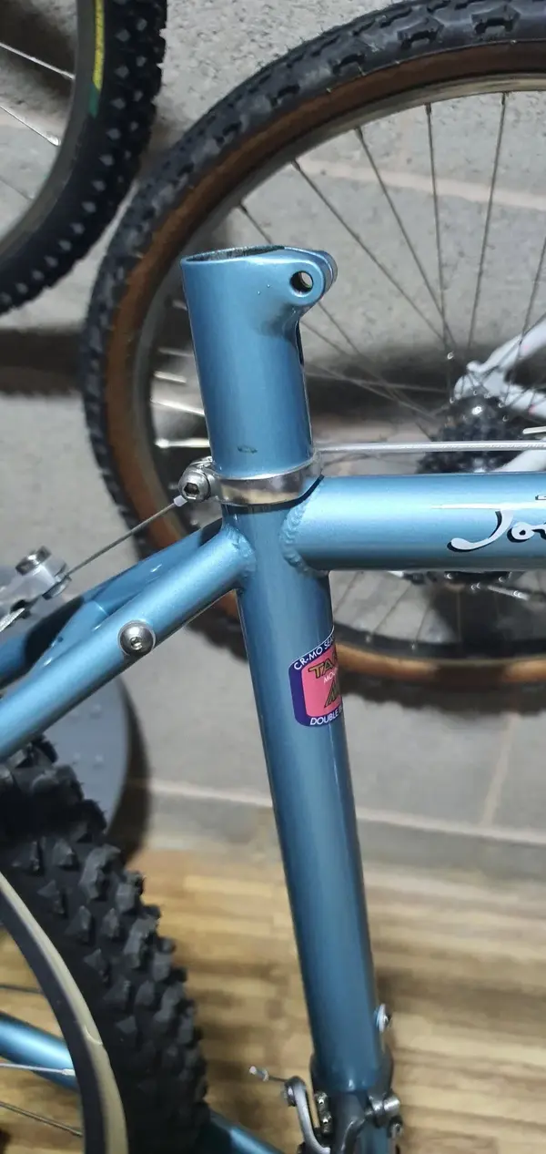

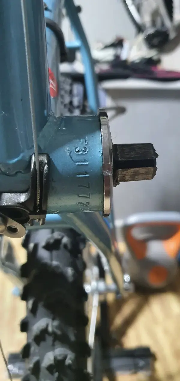

So confusion no more. It is a 1 1/8th headtube.
But it was a 1 inch headset. View attachment 554273

it wasn't a huge surprise to see these in there!!
got one-off - now the other one!
