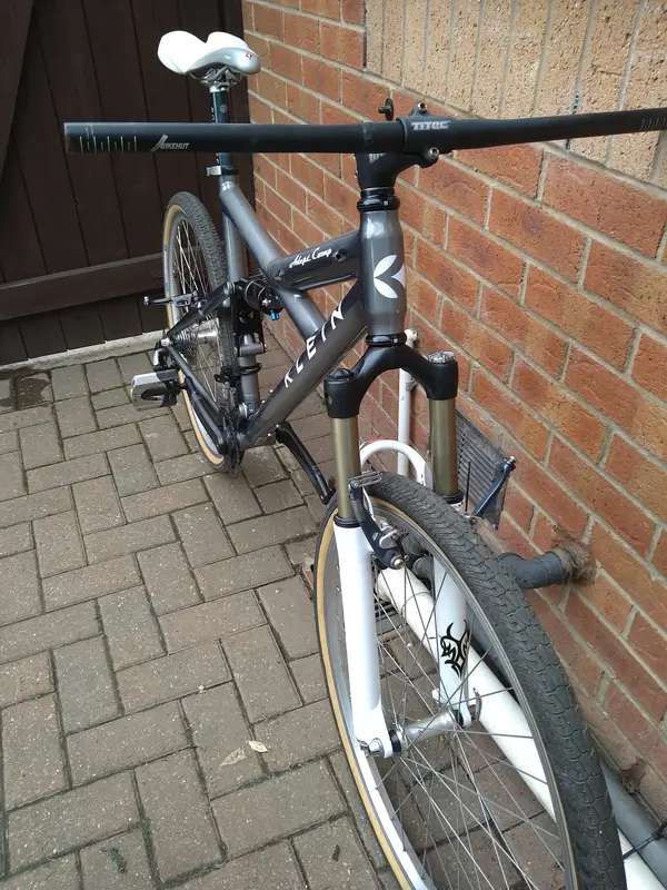

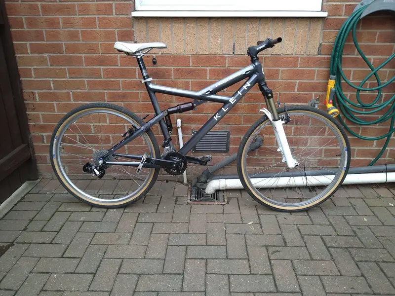

I got it as a frame set with the shock and fork, at first I thought it had a DNM budget shock but turns out to be the Cane Creek original, as is the Manitou fork though both need attention

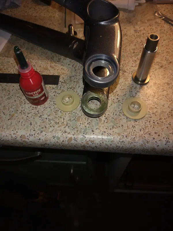

First job was to see what the bearings were like, oh wait it doesn't have any, but I did find some worn out metal bushes and bits of coke can shims
I was still able to get PTFE replacement main bushes and main pivot sleeve from Triton cycles which sorted that
![DSC_1478.JPG DSC_1478.JPG](https://www.retrobike.co.uk/data/attachments/692/692721-cf2b14cb414b50e61e0f977be587ba0b.jpg)
