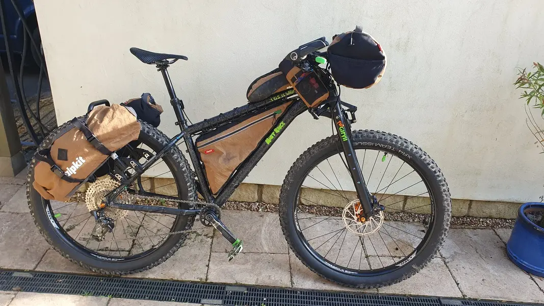

Yep that'd be me.. @danson67 's work is still going strong, caliper welded to the front of new fork legs( although I'm sure easy enough to do on existing alloy legs). Dan is the one that would know. Picture of bike loaded up for this weekends #Surly100 down in Gloucester. The forks works a treat ( had the coil shock fully rebuilt...Noleen still do full rebuild kits), the J path gives fantastic small bump sensitivity, didn't realise how much until I got back on my 160mm Enduro monster this weekend for the first time in 20 months and realised just how good the Girvins really are
Sounds promising. @danson67 has a frame of mine and also did the rear disc conversion on my RTS.
