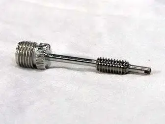

Fox Talas II IFP Charging Tool.
Half way through a full stripdown and rebuild of my newly acquired Fox Talas II fork and now I can't find my Charging Tool ;-( Definitely had it before I started. Two days of searching has revealed, in order of importance; dust balls; that little bit of metal I never even knew I'd lost, nor even its original purpose; a sweet wrapper; another dust ball, etc.
Attached pic shows a DIY model, the original Fox is the same thing only somewhat more sophisticated. But in looks only.

Hi
I own some Fox talas 2s
And when i used to pressure ifp chamber
I used a football pump valve modified (cut down & notched).
Theres a few threads out there on the web
Showing how to modify the valve...
And their was a guy making and selling them on Ebay not long ago...
Ive run my Talas II with zero pressure in ifp chamber
For the last 5 years as i get full travel and they feel more progressive ....Travel setting still work fine too.
