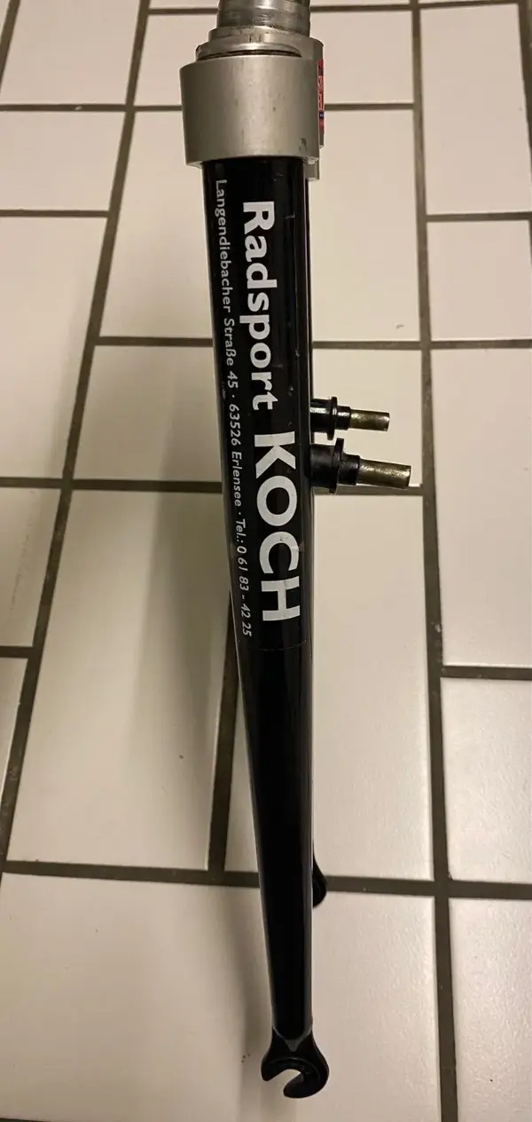

Switchblade with bent bosses?
Looking at the pictures if looks like the leg has been rotated slightly within the fork crown. Nothing bent as far as I can see.
All you would need to do us loosen the crown bolts, realign the fork leg and tighten the crown up again. Job done :)
Right, these forks can "turn" like that.
It was the side picture where it said Radsport Koch where one of the bosses seemed to have lost some viagra power.
I reckon reckon they're correct, because it means the brake boss is in line with the wheel rim rather than being at an angle.
Its just the angle of the leg in the crown. I think its twisted round a bit in relation to the other. Theres a trick to setting them straight, its on the service sheet........which.....errr...i seem to have misplaced at the moment....but if you need it..
