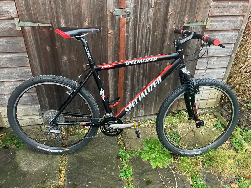

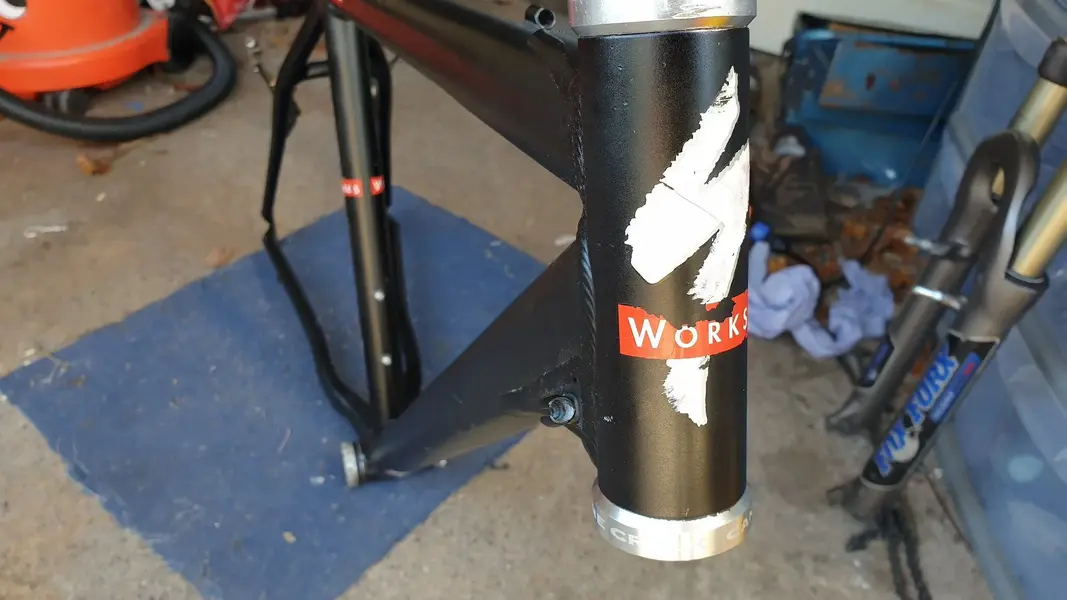

I've just picked up a so called m4 s-works hardtail
The problem is I can't seem to find the colour. It seems m4 sworks were made 2000, 01 and 02, and I think it's a 2001 because of the seat stays and what decals are left
But unsure whether it's an s works or another specialized model.
Does anyone have a catalogue? Or know what colours they did? Frame is anodised black... Can grab pics tomorrow is needed
Thanks

Why do you say "so called s-works"? Are there any S-Works decals left on it at all?
There are some decals left, sworks on headtube, underside of downtube, and m4 on the top tube, and but it's the fact that most are yellow (2000) red (2001) red/white (2002) unless there was a limited release of the black or it is in fact a different model.

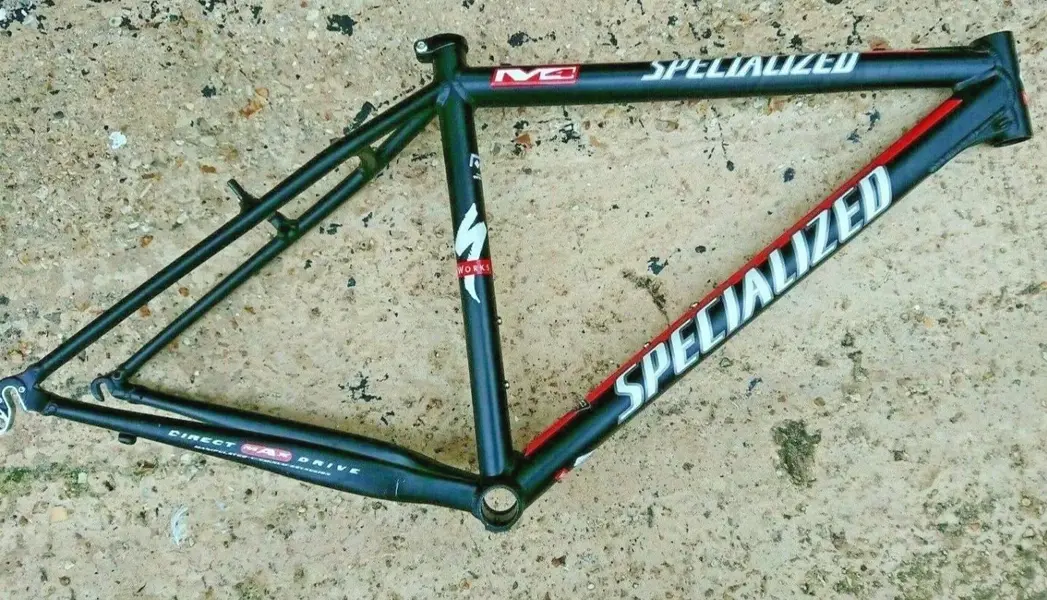

I've actually since found 1 other. It was a completed sale on ebay... So I suppose now its time to find some new decals
Great frames.Bought a black ano M5 Sworks frame,now resprayed in team red.I think that's an '00 frame.That's the year they put a stripe along the top of the down tube.Looks better without it IMO.Black ano was a standard option for a 2000 model after team red.Yellow was a standard option for '99.Think they also did an M4 in Gulf colours.

It's just I couldn't find any black ones, in the usual pic search places. Mostly red, red and white and yellow. Maybe they didn't make as many.. Or it wasn't a popular option.

Gil was my first point of call... He unfortunately didn't have anything. I can see plenty of 'm4' decals but none have the 'specific alloy manipulation' written underneath. And the chainstay ones are seeming hard to find.

The black ano ones suffered from decal loss,weren't lacquered over like the others.And possibly the texture of the ano not so good for adhesion?They offered it again a couple of years later for M5 frames,the one I got had knack all decals left.Heard people complain it wears too easily but seems tough enough to me,just not as thick as paint.
If you can find someone who has a frame with decent decals (more likely a non-ano frame!) who'll be willing to take some decent pics for you,that'll probably save you a lot of hassle.
Didn't have any luck with that myself.Posted a wanted add,contacted owners through here and ebay but I couldn't find anyone with the right frame as an example.If you can get a good,clear pic of the decals you need it should be possible to reproduce them.The M4/chainstay/metal matrix decals should be the same for a few Stumpjumper models.
