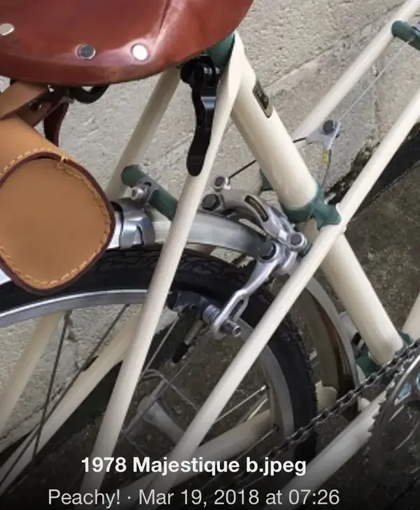

I bought some from Germany for my daughters Majestique;
But I’m sure I bought the 130mm or 140mm version, I don’t remember it being as long as 300.
