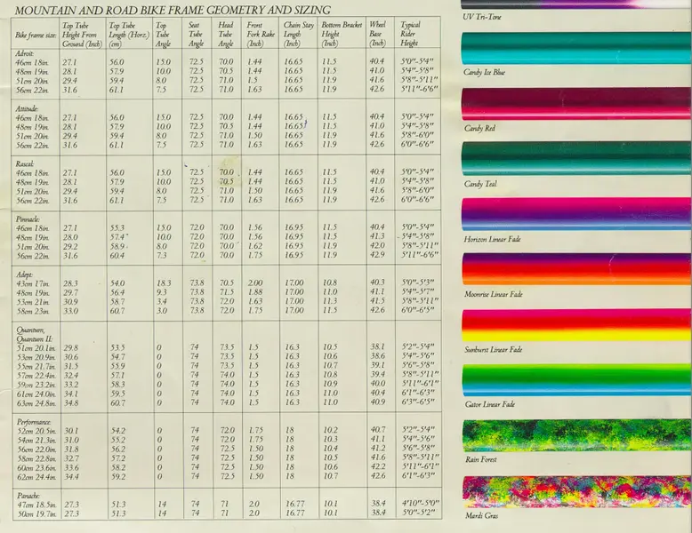

So I’m a little confused over Klein sizing. I’m 5”10 and 32 leg. Pretty sure my Gary Fisher is 19” and very comfortable but I thought that would be a medium ?
Here are your size recommendations according to the 1993 KLEIN catalogue. I am sure that goes ok with later 90s models. Maybe?:
For 5 10 it would be a 20" inches frame.
Klein sizes are messed up, a 19" isn't actually 19"...best to go by the chart above, you need a 20" medium (although I'm a whisker over 6' and my M is absolutely miles too small for me).
