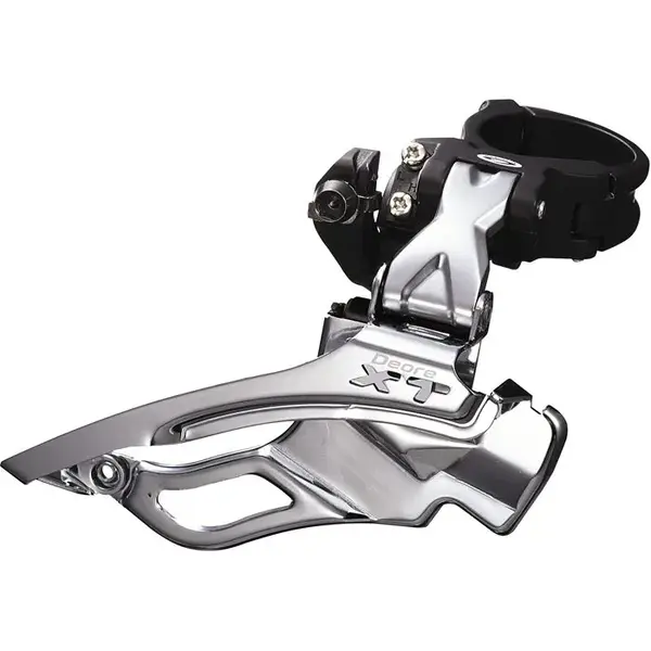

I've got this front mech that I used for a while as a top pull
Now have a bike that I want to use with a bottom pull
It says it's dual pull after looking. Does anyone have a pic bottom and top?
Just to help figure it out, thanks

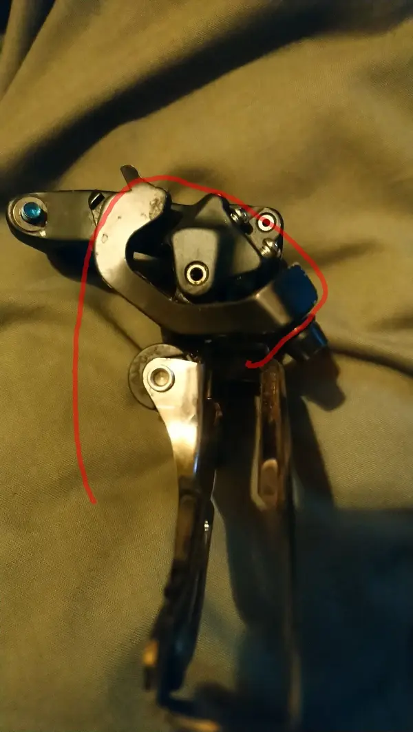

It should have a cam type thing on the linkage, cable comes up from the bottom around the cam and tightens up in the same place as if you're using it top pull.
