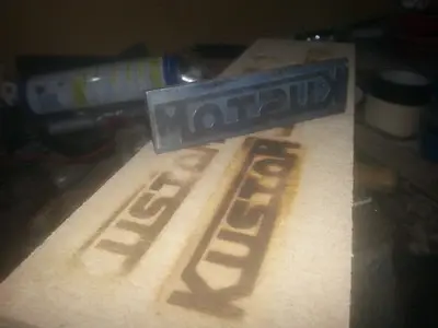

the silhouette is perfect for head badges with a bit of extra work.
look at electro or acid etching. use the silhouette to plot the logo resist, stick it to aluminium, dump in chosen etching method, done.
there is someone (sorry I forget your name) here who does this for custom head badges, I do it for other random stuff.
