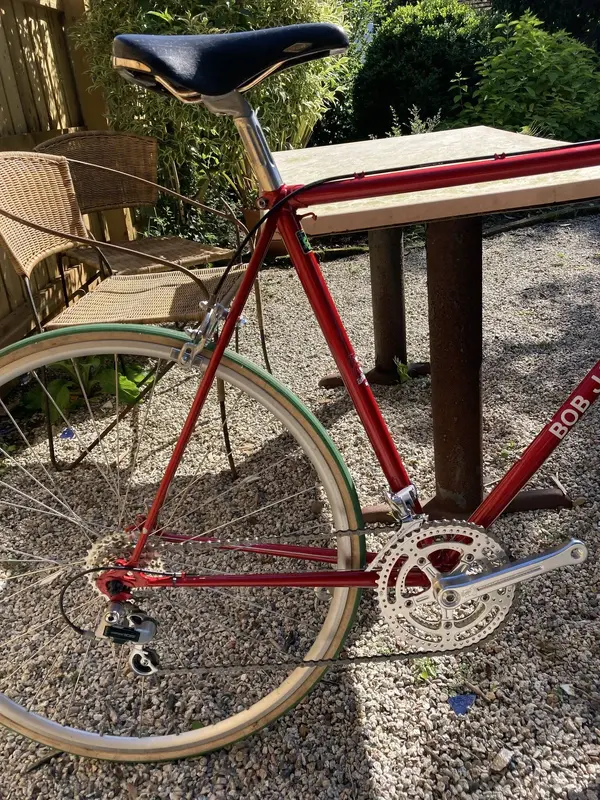

Bob Jackson 1964
Really like this bike. Can you give me a rough idea of your winter cleaning post ride and maintenance. Do you use a pressure washer and avoid seals and bearings etc? Im in rainy Ireland...

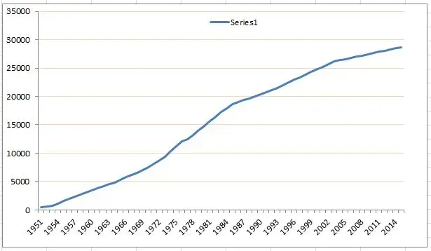

Just for interest I have attached a graph of Bob Jackson frame numbers that I have been putting together. This is broad brush stuff but appears faily accurate. If anyone reading this has a BJ frame can they send me the year and frame number and I would add it into the info I have. On the graph obviously frame numbers are on the vertical axis with years along the bottom. I would particualrly like info from around 1958, 1997 and 2007. Thanks.

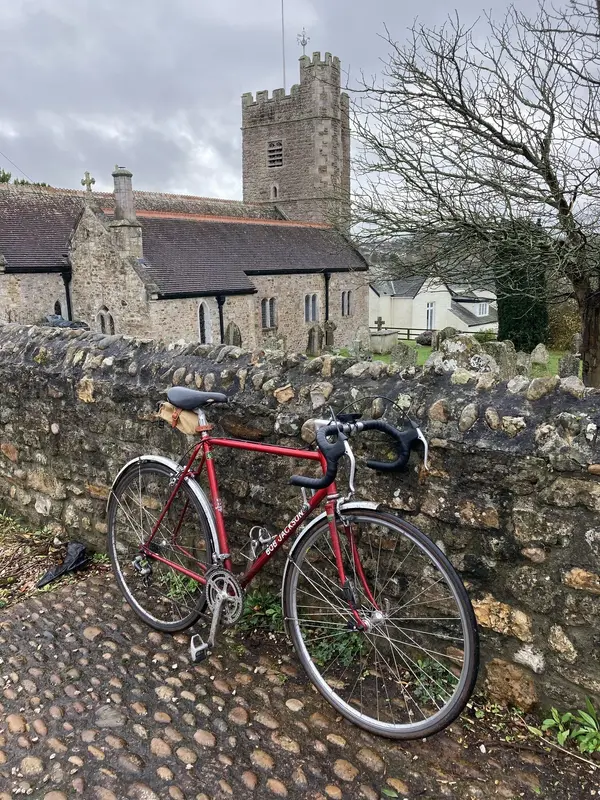

Your commuting on that bike on Devon roads?!
Shame on you!!
The roads around here are awful, much worse than the roads in Yorkshire both in condition, dirt and dangers....
Bikes are for riding!
I know what you mean about the roads though. Sad to say the demise of my own Bob Jackson was due to one too many potholes round here. I sold the broken frame on eBay and as far as I know the new owner got it repaired with a new downtube.
