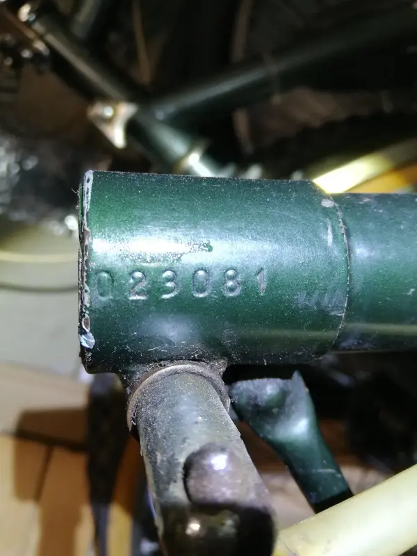

From the attached image I have: 023081 so what would that be? - I'm not sure where the 'K' number has gone but it's not on the seat post collar. I checked both sides and can't see it, maybe it's been filled with paint at the factory.

Going from the first pic, your bike looks like a Mk II Deluxe which was manufactured from 1963 to 1967. I think it is a Raleigh produced frame since it has the combo of a Nottingham headtube badge, a rotated seat tube and a removable crossbar tail. The ovalised seat tube is wider across the bottom bracket when viewed from the rear, whereas on the Bradford-on-Avon produced bikes the seat tube was wider when viewed from the side.
Raleigh production of the Mk II frame ran from 1967 to 1970 (the Deluxe in 1967 and the Major / Major Deluxe from 1968 to 70), therefore, in theory your bike should be from the crossover year of 1967.
A guy called Jack Finucan maintains a register of Moulton bikes and you can add yours to the database by emailing him at moulton dot registry at gmail dot com
There are a few other Deluxes in the database from 1967 but not many at all really. Your’s may be one of a handful made before production of the Major ramped up. Based on the other serial numbers from 1967 onwards, it looks like Raleigh probably changed the serial numbering scheme, so the week / # bike built thing above is likely a bum steer.
