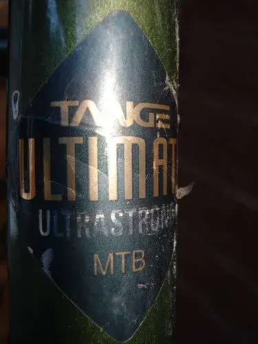

One possibility that occurs to me is that I read somewhere that under US consumer protection law, the sticker has to be true only of what it is attached to. So it isn't impossible that the top and down tubes are Superlight and it's just the seat tube that is Ultralight.
For example, the bike shown below had an Ultrastrong down tube and seat tube, but an Ultralight top tube. And the previous year's model didn't have an Ultimate badge at all, because its seat tube was Concept - even though it had an Ultrastrong down tube and an Ultralight top tube.
Just a possibility.
[edited to include 'the bike shown below' that wasn't]

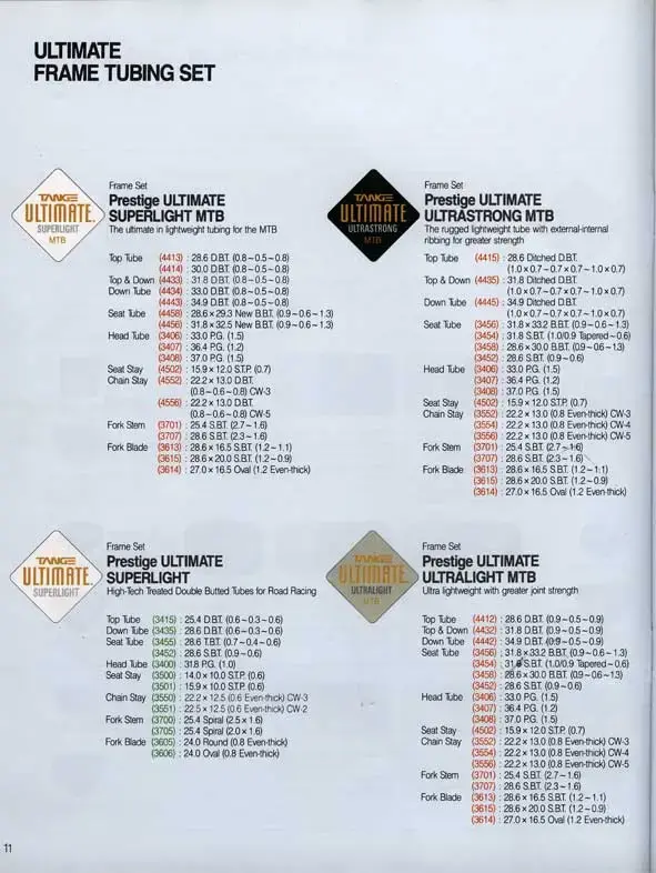

Yes, I'm sure it's just the butts that differ, the basic tubes are the same heat-treated 0.5mm material. Typically a butted tube of say 55cm (TT) will have around 10cm of butted length, 8cm of taper and so the remaining 37cm is the basic 0.5cm tube. so my excel tells me that a 8-5-8 tube will be about 4% lighter than a 9-5-9. And the top and down tubes weigh c800g say, so you're talking about 30g difference. Not a lot, if you're gaining extra strength by the butt being 0.4 instead of 0.3. Although it must be said that 0.3mm butts is pretty much the standard, and 0.4 is quite rare.

30g is not a lot at all. And it looks like the seatube is the same.
There are two superlights, the lower one with the thinner butts is road frame.
