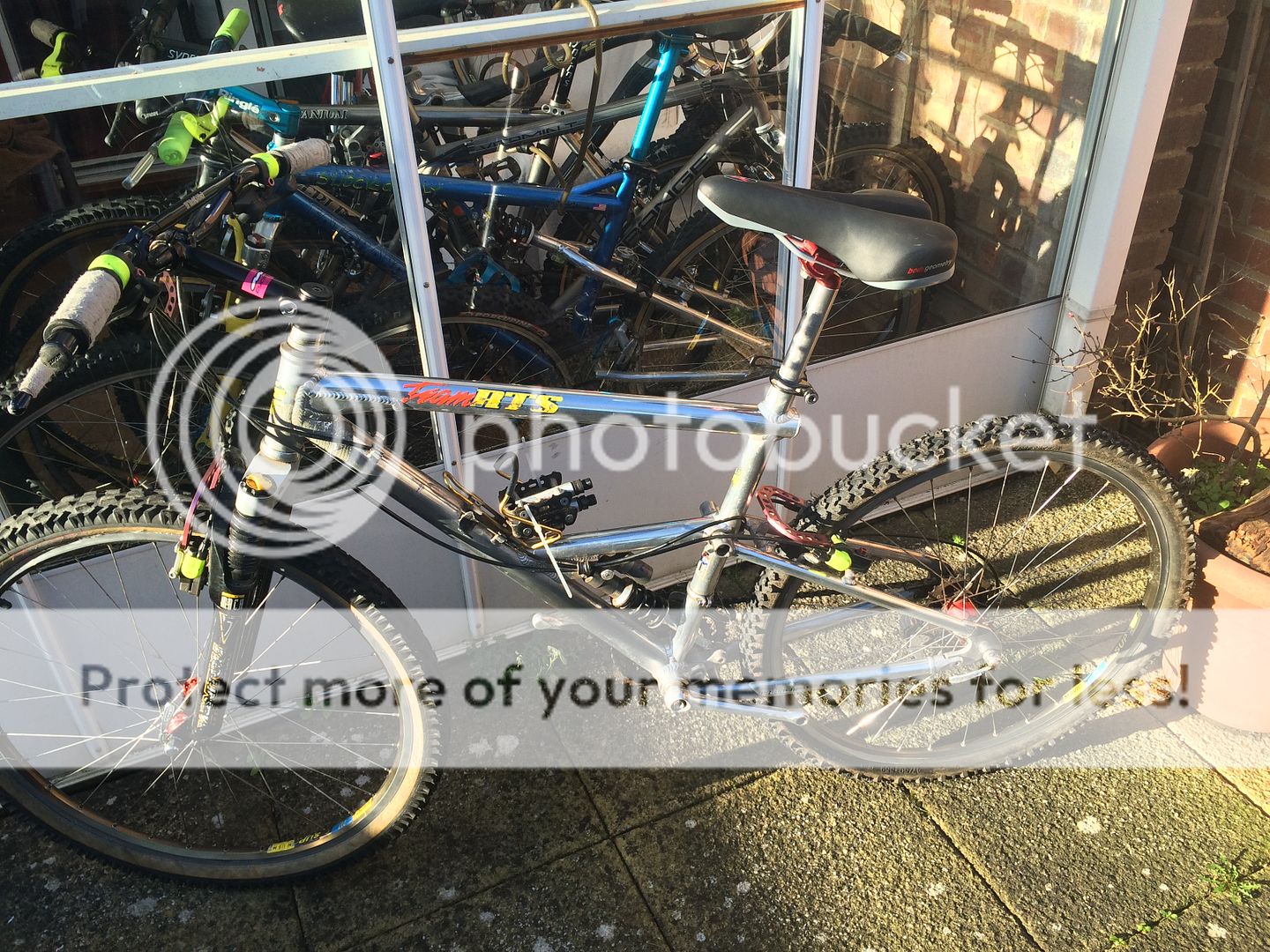

Hey guys, a new purchase arrived yesterday in the largest bike box I have ever seen. Apparently it held a pretty much fully built Cube 29er previously so this was rattling around in it ;)
Does anyone know the year from the pics and frame number?

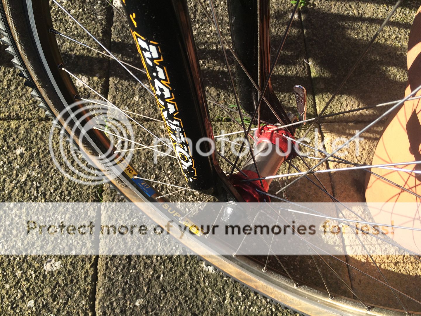

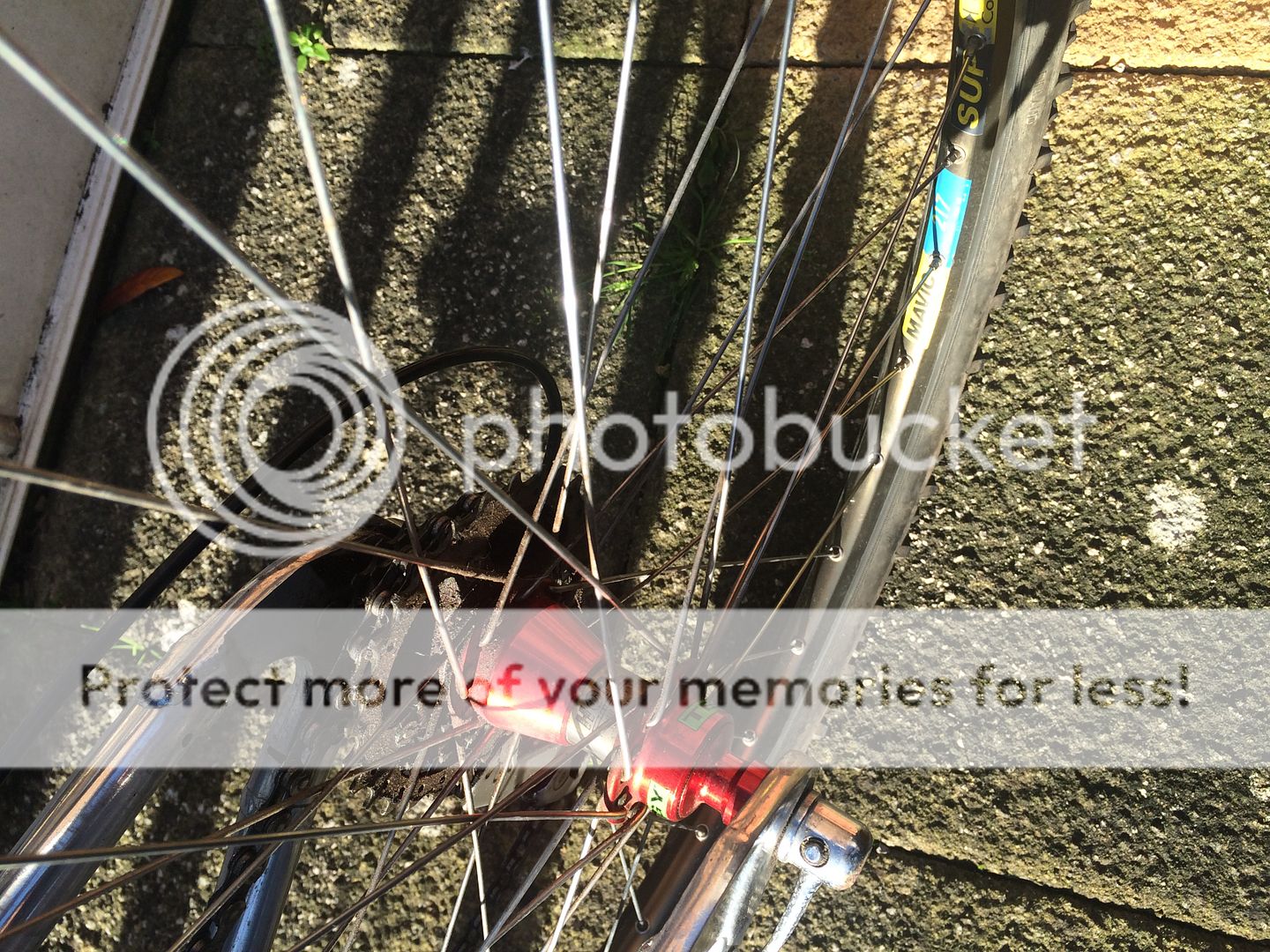

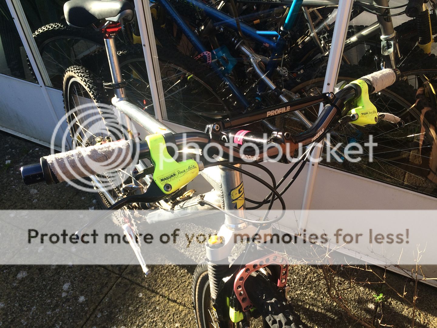

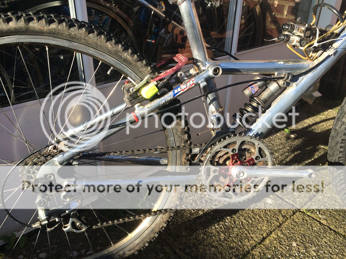

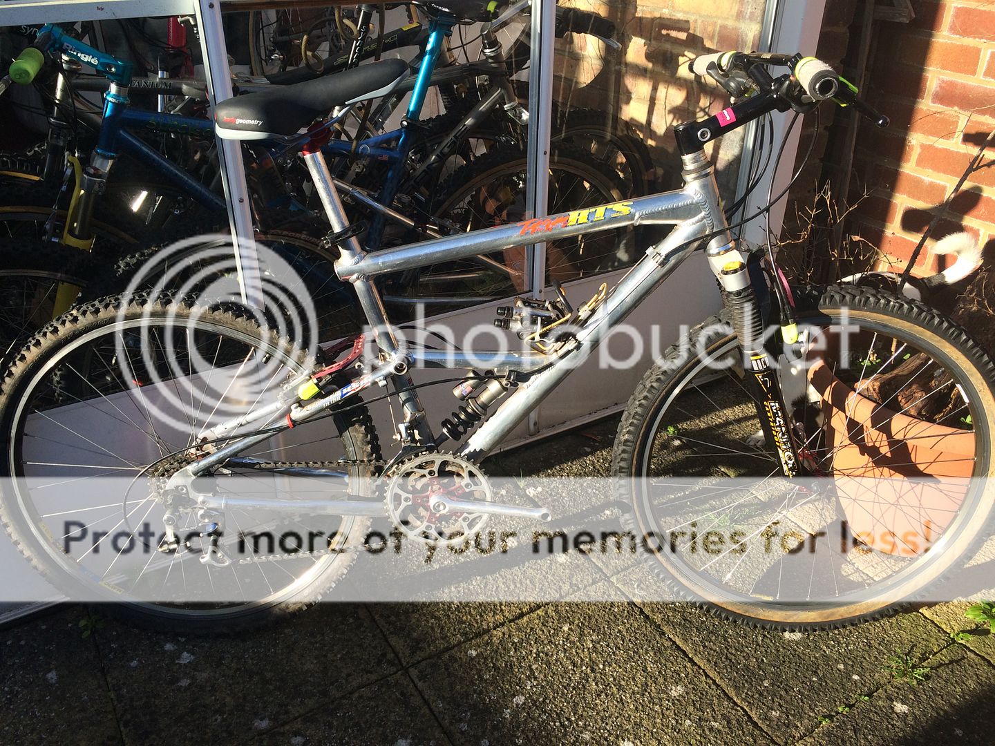

Here are some pics of her current setup as bought, spec list below:
Frame: 16 " GT RTS Team with Noleen piggyback rear shock. Frame number 092436
Fork: Manitou Mach 5
Headset: Ritchey Aheadset
Stem: Sunn Cycledelic ahead
Handlebar: Profile riser with brace
Grips: Gripshift
Barends: None
Brakes: Magura yellow Race-lines with red alloy boosters
Brake Pads: Magura green
Brake Cables: Magura hydraulic
Cantilever cable hangers: n/a
Brake Levers: Magura yellow Race-lines
Shifters: Shimano XTR
Front Derailleur: Shimano XTR M901 top pull
Rear Derailleur: Shimano XT M737 short cage
Derailleur Cables: Shimano SIS
Cassette: Shimano XT 8 speed
Chain: SACHS
Cranks: Toplines in polished silver, 5 arm red spider. Non compact
Crank Bolts: White Industies Titanium
Chainrings: Shimano SG
Chainring bolts: Black alloy
Bottom Bracket: Titanium White Industries
Pedals: Shimano M323 combined platform and SPD
Hub Skewers: Shimano
Rims: Mavic 217 SUP in bronze
Hubs: Hope Technology Titanium wide bodied with red flanges
Nipples: Brass
Spokes: Double butted stainless
Tyres: Front - Panaracer Smoke Dart HC 2.1
Rear - Nokian EX-TRACK
Tubes:
Saddle: Specialized Body Geometry
Seatpost: X-Lite alloy with red clamp head
Seat post Binder: Black alloy quick release
Fantastic bike, always loved the RTS! Your plans are perfect for the bike - nice collection in the background also!!
Perfect parts choice imho. Especially to swap out those Manitou forks. Based on the piggyback and the aluminium rear triangle this should be a later model. 94 would be my guess.
