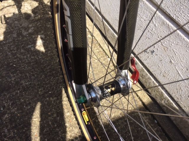

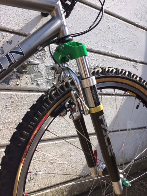

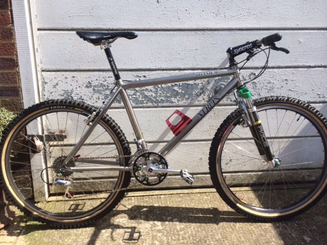

Right, about time I posted some details about my Merlin. I bought the frame and forks from a very kind RetroBiker in Canada who shipped this to the UK last spring, initially she was built with a Rasta theme based on the lovely anodised Salsa skewers she came with and the forks parts in homage to the previous owners plans. However having owned and then sold a stunning Ridgeback/Merlin Titanium which just looked pure class in it's neutral Silver and Black colours, I decided to tone down and go simple with this build.
This is one bike I will never part with, It's my sunny day pub lunch cross country rider :LOL:
I do have one dilemma, the current Pace RC35's don't offer much travel but are very light and are age correct, I have recently acquired some Pace MXCD's which offer more/ smoother travel. They will create a steeper head tube angle. Would you swap out for a better ride or keep as it?

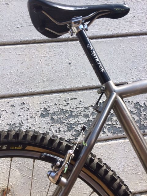

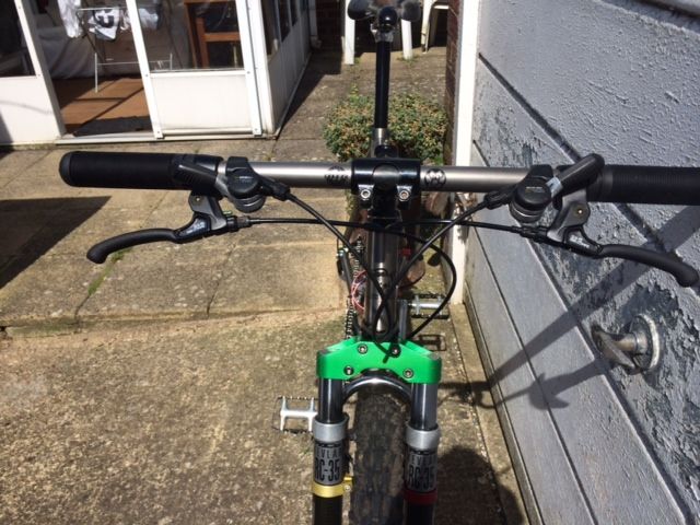

Right, pics of the Rasta theme when it was sunny:
As she now stands, sorry about the indoor pics. It's always raining when I find time to do this!
Hope you like it :D

Thanks guys, appreciate the comments. I love yours Ant, I don't know quite why but I think Merlins look so much better without coloured bling ;)
Very very interesting.
Good job, also if I prefer rigid forks on a Merlin.
Are those original decals?
I believe they are. I have a rigid Rocky Mountain but needed something with Pace on and they just seem to suit a Ti frame so well.
