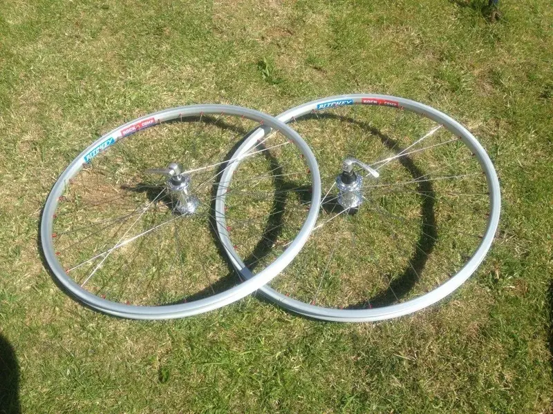

I also (not today) built up my own wheels for this one, never done this before so will be interesting.... :shock: :LOL: :shock:

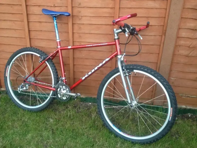

The final result is this:
(The blue post and saddle will be swapped when I get suitable replacements)
The two things that immediately surprised me were
1, How high the bars were! Kona's always give me the impression of being long and low, which is a style I like, but the bars on this are 2" higher than my Orange, and it's older by 3 years at least!
2, The reach, it was no way near as stretched as I'd expected.
I shall try it as it is, but may well opt for a different seatpost and stem combination to try and stretch/lower the position.

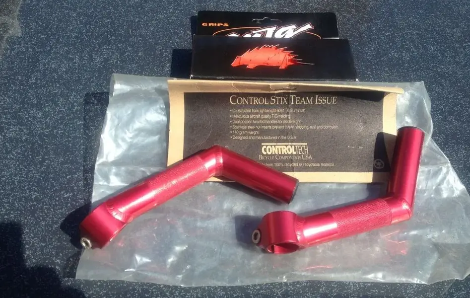

Barends: NOS Control Tech Control Stix

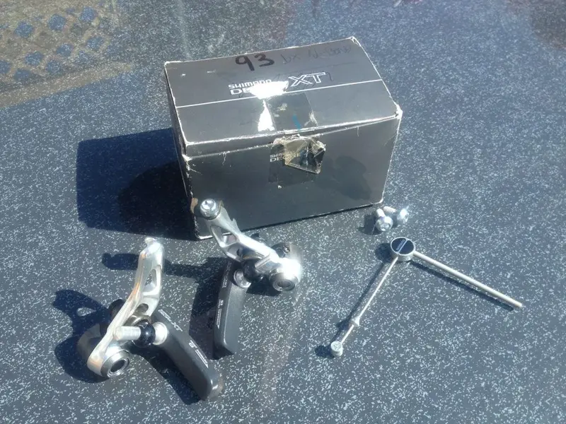

Brakes: NOS Shimano XT BR-M737 Front and Rear
Brake Pads: NOS Shimano XT

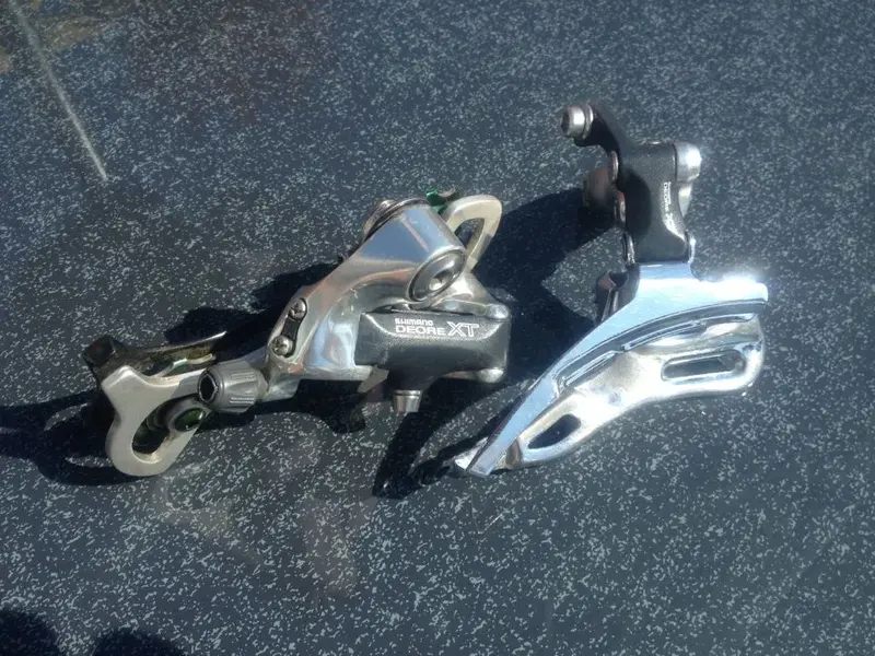

Front Derailleur: Shimano FD-M737 26.8mm band
Rear Derailleur: Shimano RD-M737 with Alloy jockey wheels

That looks smart.
If the seat post is as faded as it looks why not strip and polish it?
that looks cool.ykt!
id like to dib the post and saddle depending on price, look good on my white and blue klein. don't mind faded post either.....it's for riding :D
Very tidy.
Only suggestion I would make is a silver seatpost and black saddle, but its all personal perference. Looks a fun bike.

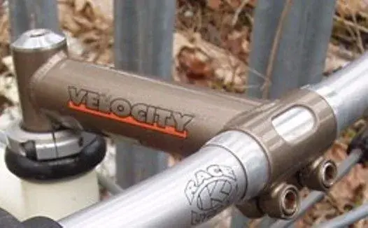

If anyone has one of these in decent condition
I'll swap it for the one on this bike

I have that stem in the same colour as yours now, butthe twin bolted cromoly one in 125mm length. I swapped it out for a 100mm alloy velocity one cos I was too stretched out, yours for 15 quid in good nick if you want it, just pm me

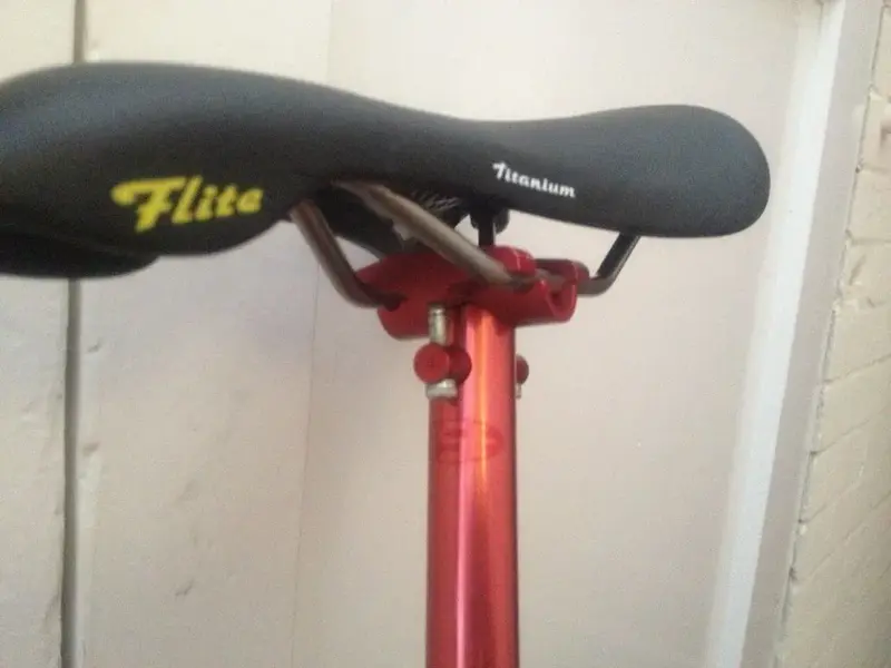

Got the replacement Post & saddle, The USE post is faded, but I like the effect where the sticker was :D
Other than having to tighten the front hub cones a touch, everything seems to be working well, Very pleased with the wheels, they have stayed true even after being ridden and jumped off some steps :roll: :D

I like the seat.
I have a slight aversion to trying to match too much red ano - the shades always clash so I would still prefer a silver seat pin! The USE one is very nice though. Glad the wheel building went well!
