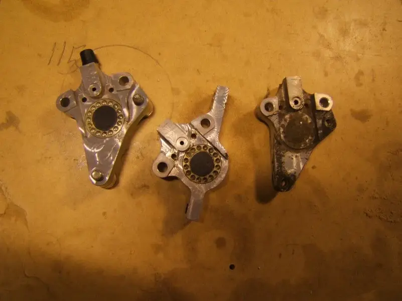

Example pic for you
L-R
A.New No3 Caliper
B.Looked after No9 caliper
C.Didnt bother arse, stuck bike in shed.
