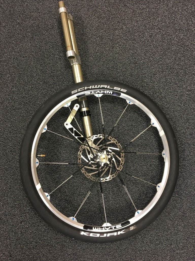

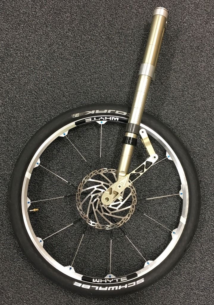

Not exactly a "Readers Bike", but more a "Readers front end", I bought this USE SUB fork (or to give it its full name, the Ultimate Sports Engineering Stability Under Braking Monoshock) a year ago and tucked it away a cupboard for later tinkering. 12 months later I dug it out and took a closer look to see if I could do something with it.
It was a bit tired and the linkage had plenty of play in it, but the important bits were all in very good nick with not a hint of wear on the main stanchion. So I stripped it down, cleaned it and treated it to a few new parts. I've installed 6 new bushes from Igus, fitted a new main bushing and lip seal in the shocker, overhauled the air sprung and damper, treated the whole thing to lashings of new grease, and slapped on a new SUB decal too. To all intents and purposes it's like new.
Originally they came with conventional 3 cross wheels built around a modified Hope Bulb or USE's own "SubHub", I have two such wheels already, but idle hands and a shed full of other bits had me wondering if something more interesting could be made to fit. A spare bit of stainless and an hour at a lathe (haven't used one for over 20 years - so I need a couple of goes!) resulted in this.
Just need something to bolt it onto now.

If only the Lefty could be stripped, serviced, rebuilt and restored as easily. This thing requires three Allen keys, and can be stripped to its component parts by an utter bafoon in about 8 minutes. It's the easiest suspension unit I've ever serviced by a huge margin. Shame they didn't keep making them because the basic principle is sound, and with all the space inside the damping unit could easily have been adapted or replaced with one with more modern features like lock out and platform damping.
