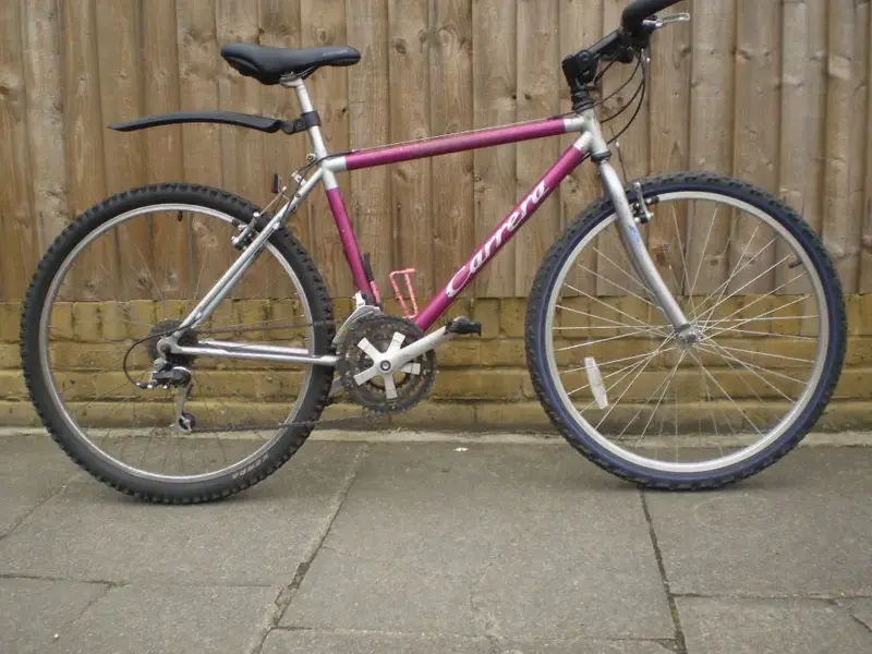

Are you sure this hasn't been a frame resprayed by Fleet at some point in time, and the forks colour matched too.?
The headtube, tig welding, rear canti hanger cable routing, rear stays all look like a Carrera to me looking at it quickly.
in a hurry these are a couple of pics of similar.
Given the weight and spec, it might be an option.
hope its a help.

That Carrera does look quite similar.
Orange Prestige 1993 frame & forks is quoted as being 6.5lbs, so 5lbs for the frame isn't so bad.

It does look rather similar, but seems like quite an extent to go to (respray, matching forks, upgraded components) for a Carrera bike. Stranger things have happened though I suppose?
Lol, no. I did have a girlfriend dump me for another girl though.
I'd assumed that the frame was originally built by Fleet, then someone else painted it and had the decals made. This seemed to be the case after it arrived as well judging by the respray quality! The fades are good but there are paint runs and it has been not stripped of the old paint very well as you can see it underneath!
