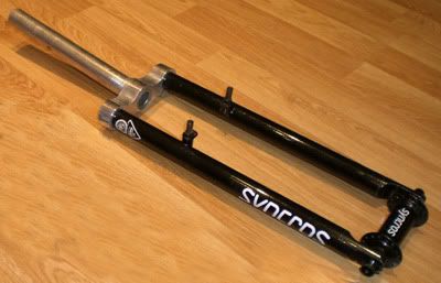

Technically, i'd say that you're right... but they'd just look wrong with a Mag crown:
(Poached from Jez's '08 for sale thread :) )

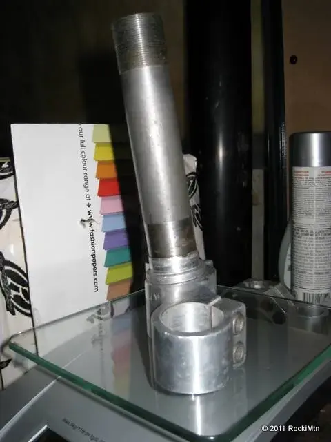

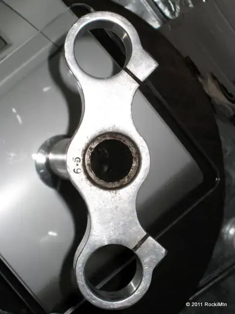

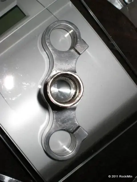

not sure if i should bring this up as i'm not looking to part with it, but i have a 1" crown. and even if i do part, i've already promised first refusal to another RB user.
this is in fairly good condition, but typical is the fact that the steerer is short at being about 5" in length with 1" of threads. was originally intended for my Merlin build, but because of the need for a longer steerer and no easy way to do it, it got socked as i found a bonty composite which has a crown that easily facilitates swapping out the steerer.
not sure how you'd get a 1-1/8" to work, as i see no easy way of pressing the steerer in/out as it's at an angle to the crown, as opposed to being 90°. as well, i'd assume that bonding was used along side press fitting the steerer. only real conclusion i was given by neilll to make the crown usable was to have the steerer extended by grafting/sleeving.
Well if it does become available let me know as I think it would look great on my Toad.
Try finding a good condition one with 1-1/8" steerer at ~170mm threaded, nope they all have short steerers for some reason.
