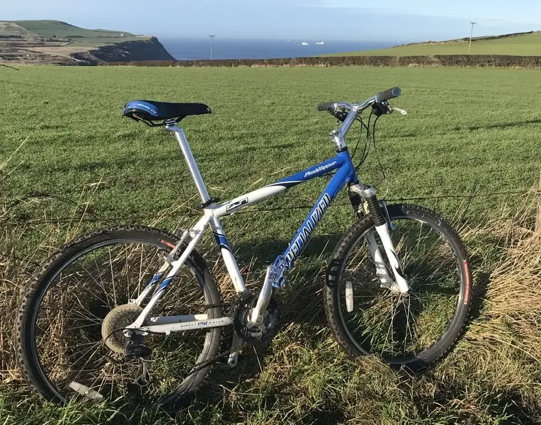

Oh and I have a 17” specialised alloy frame and forks you can have for £10 plus post.

Thank you very much but they both have a straight top tube meaning the rider will have to cock her leg to get on. We are looking for something with a lower or swooping top tube.
