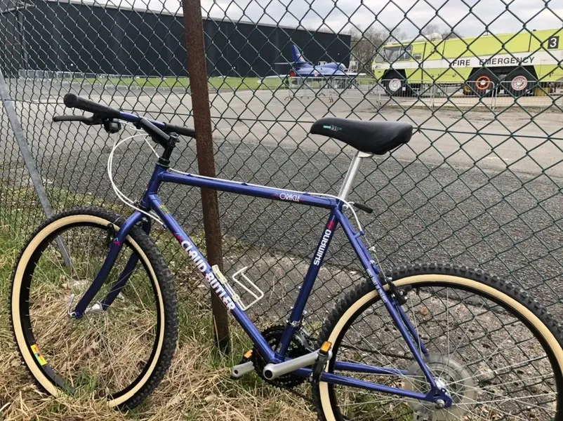

Simple.. the aluminium rigid bikes cracked and were binned, the steel didn’t and survived....
(Today’s lunchtime pootle)
I suppose it could be argued that mass produced Alu frames were still an experiment in the 1990s, whereas brazed and lugged steel frames had been proven through decades of building and use.
Is that an RAF base and a Hawk?
Yorkshire Air Museum and that’s a Hunter. The most beautiful Cold War fighter IMO :D
