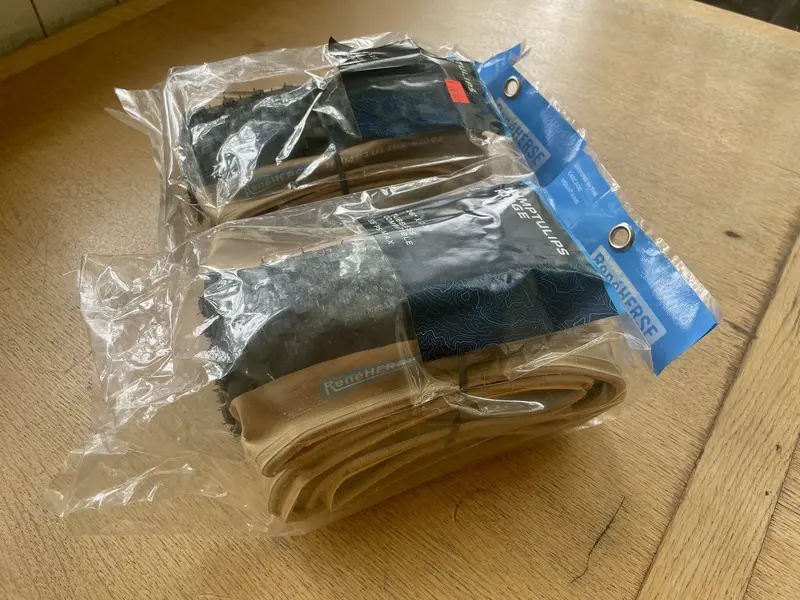

Tires were any easy choice:
I've recently been riding these Rene Herse Humptulip Ridge's on my other bikes, and I have to say they've quickly become an expensive new favourite.

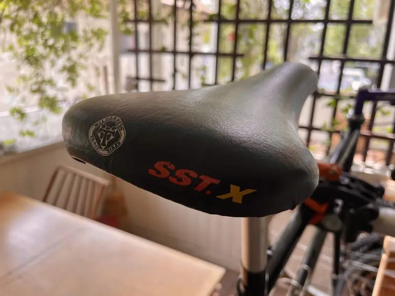

I luckily had an old WTB SST.X saddle on hand that I'd purchased while working on the Phoenix, and it was a no brainer replacement for the newer WTB saddle the bike came with:

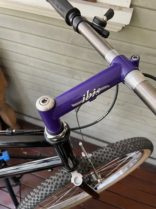

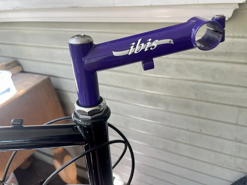

The stem was a little trickier.
I had only 1" options on hand, and @raidan73 had pointed out before its arrival that the Sovereign would almost certainly come with a 1 1/8" steerer.
Mulling this over, I happened to check eBay one morning in the line for bagels while we were in Texas, and a nice, perfectly sized purple Salsa-made Ibis number popped right up for $80.

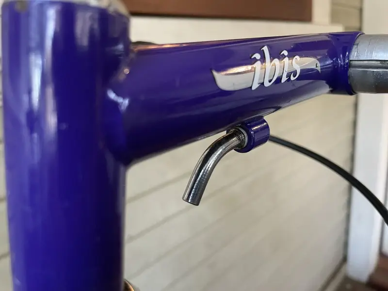

Some of you may remember I'd been asking about these stems. Well, confirmed by Ross himself, they were made for Ibis by Ross and his team, to the exact specifications Scott Nichols had requested. I'm not sure how many of these are out there, or what models they came on originally, but the noodle is a nice piece of effective design, and the rest of the stem is exactly as you'd expect from a Salsa Moto product.
I.E. Lovely.
Now the color might be an odd choice on an all black and silver bike, but I had other ideas for a longterm solution and my main focus was getting the bike ridable for me so I could asses what other changes, if any, I'd like to make.
It also happens to be almost the perfect size: 125mm long, with a 10-degree rise.
As you can see above, the one problem is that it doesn't have the actual noodle!

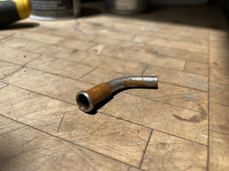

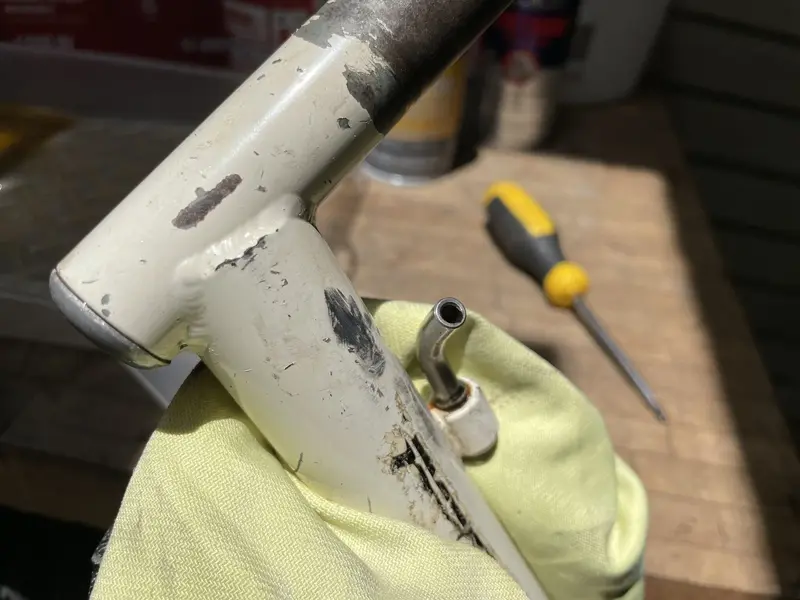

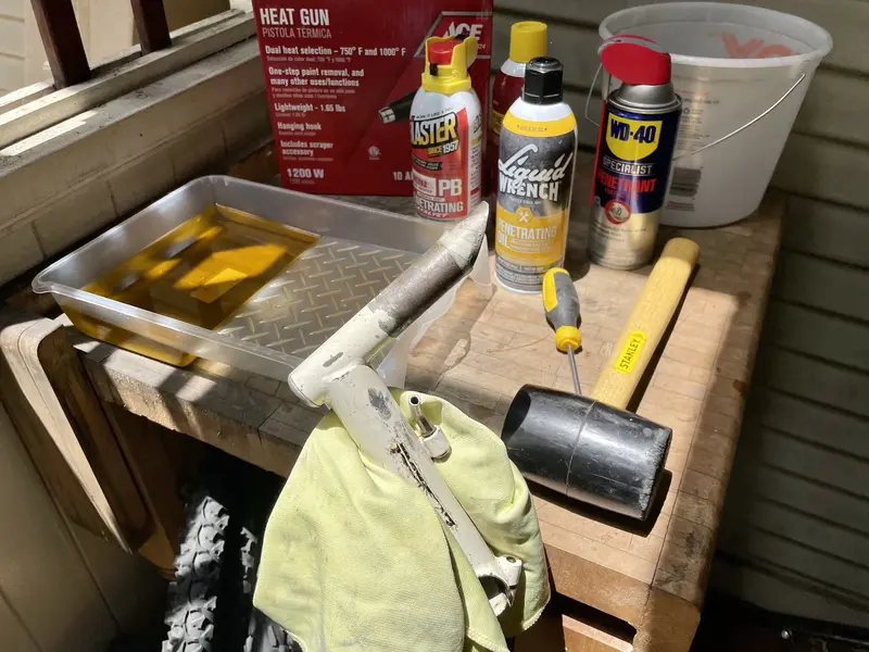

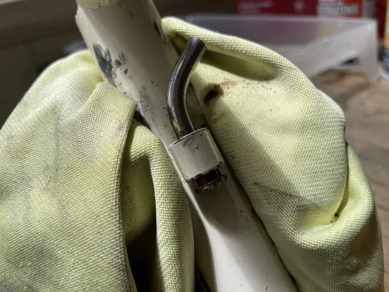

No problem! Part of the pile of parts I'd been collecting in the UK included a fairly well-worn white Salsa stem, that @iveto1983 had kindly sent my way after I'd posted in the other forum inquiring about them. And his had the noodle! At 150mm the white one was far too long for this bike, but I figured switching the noodle over would be pretty straight forward.
Well, turns out that little bastard was stuck fast with rust. So into an overnight bath of penetrating oil it went!
I'll run through that little process and the finished results in the next post...
You don’t need both sets of bars, you should sell me a pair 😅 I’d even let you keep the shim!
So the morning after the penetrating bath (seen left, below), I applied a little heat, gave it a little wiggle back and forth with a few hits of the mallet, and started to get some lateral movement. A few more wacks and a slight gap appeared, a few more and she was free!
Work station:
A bit of movement:
I see light!
She's out:
A bit of a clean:
And a noodle from one stem was ready to slot into the braze-on on the other.
Except, it wasn't!

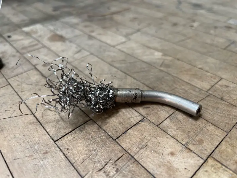

Because one thing I hadn't accounted for is that the noodles were made specifically for their respective stem sizes. Which means not only the angle of the bend changes (due to where it's positioned on the stem, and so how far away the stop might be from the headtube, and thus the brake) but also, I guess, the circumference of the noodle itself. Because it turns out this one was too loose inside the smaller, purple stem.
Luckily, I already had a beer on the go:
And I love an aluminum can shim!
Like a glove!
I know it's minor, but it's little projects like these that I sometimes feel are the most rewarding while working on old bikes.
Anyway, the angle is still an issue, as the cable doesn't drop perfectly vertically, but so far it's not proved a problem at all. There's no cable rub, nor reduction in braking performance, and although I plan to keep an eye on it, I'm pretty happy with the cockpit for now:
Keen eyes will spot a front brake change too. But more on that, and why the Ibis stem won't be staying forever in my next post.
