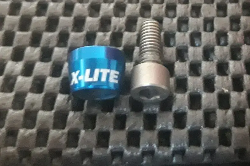

I am looking to replace the brake bolts that are use on my bike and I would like to know what bolts might work as replacements.
The bolts in use are X-lite Brake bolts and I would like to replace them with some ones that match the silver cantilever brakes.
I think that they might be M6 x 20 but I am note sure.
I also want them to fit flush like in the second picture too without the need of a cap.
Here is a picture of the bolt and cover.

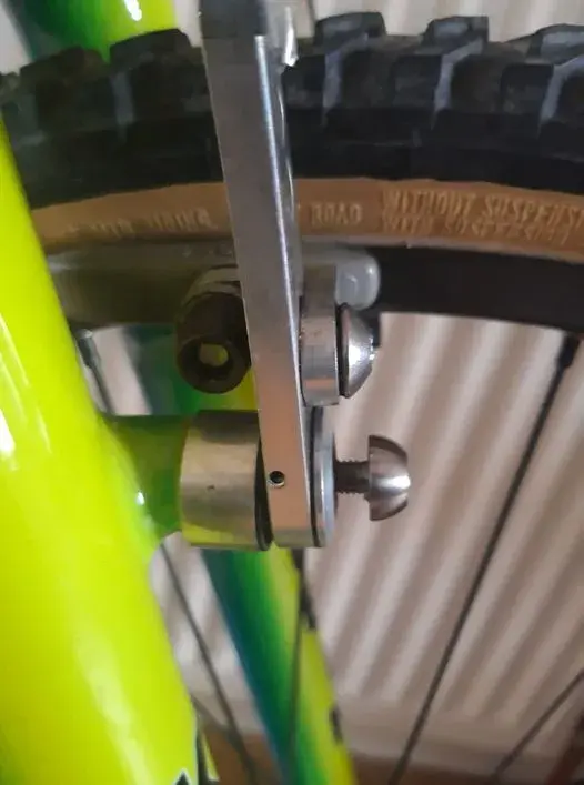

And this is what I want to get to.

Measure them
M Number is the diameter of the threaded but.
Length is the length off the shaft under the head.
I think that x-lite was in Titanium
But just look them up and find the head style you want. You can get different length 14, 15, 20mm etc.
14mm is usually a nice length. (M6 is canti/vbrake size as you guessed)

Hi, yes I will measure them tomorrow and try and get some ordered.
I was looking at these. https://www.uberbikecomponents.com/view ... de-Kit-Raw But I might have to cut a bit off the thread to get an exact fit.
You should be fine without cutting them. Brake bosses tend to be quite long once you factor in the brake too.
Some of mine will not fit 25mm in, main trouble will be fork bosses.
Shimano use 13.6/14mm for canti levers and for vbrake about 15mm (they hang over the end of the boss a bit more)
Do Not Cut Them
Been there, done that with Ti bolts and it is not worth the effort. Just get the proper length to start with.

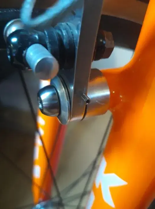

Hi, yes I am trying to avoid cutting them but I ran into problems when I tried putting the bolt from the orange forks into the fork boss in this picture.
You can see the overhang that I want to avoid. I want the bolt to fit flush to the brakes.
