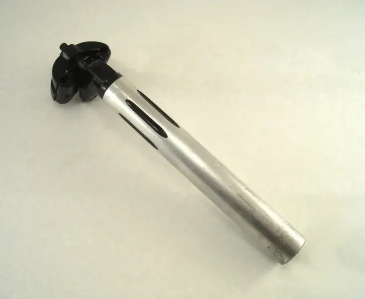

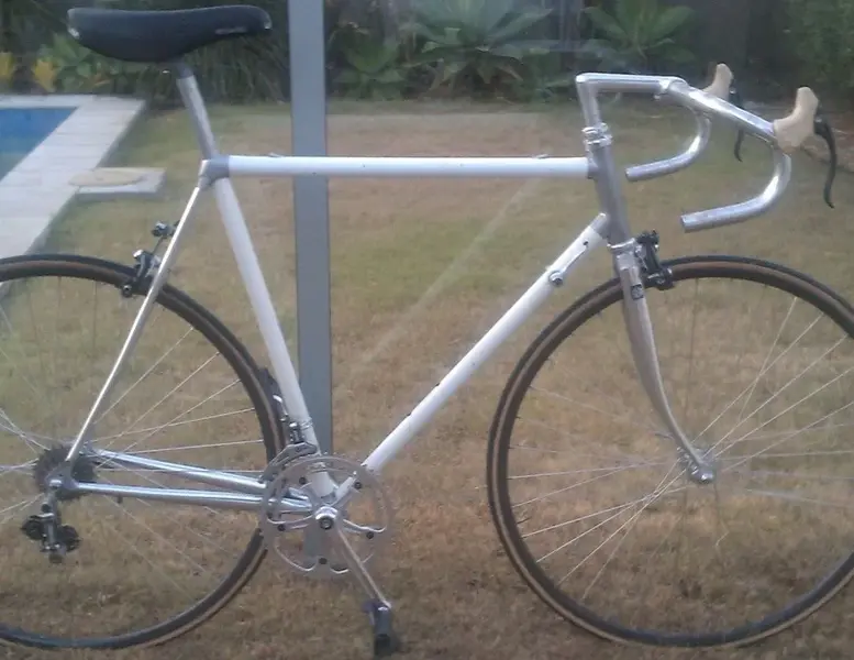

It has taken a while but i have finally got a model 310 headset and a rubis seatpost so i can remove the stronglight /campagnolo ones I had and get this build finished at last

Looking good so far :wink:
I'm trying to get some Mavic parts together as well. I like that chainset, but think as an early '90s build, it would look out of place on mine
Look forward to finished pics, out on the road

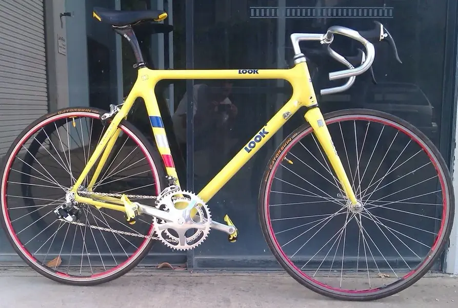

also finishing this later Look at the same time Mike Muz

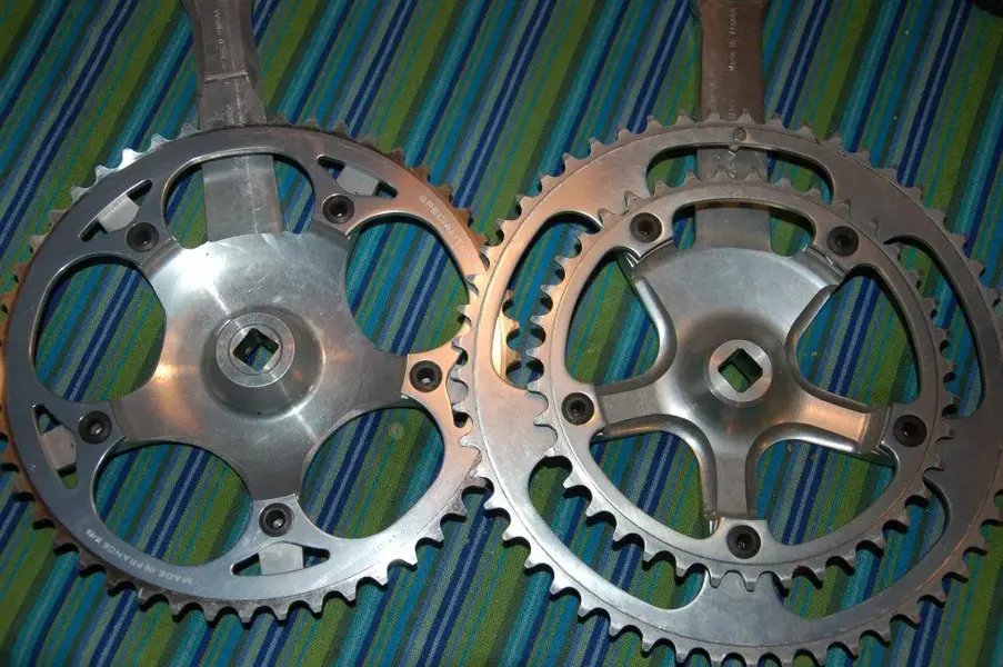

The Look now has mavic brake levers , 821 gear levers and 571 HG cassette Hubs laced to open SUP rims . Are you looking for the starfish 1 or starfish 2 cranks Mike ?

TBH I'M not sure. Looking for a double 39/53 ish. What's the difference mate? And whats the bcd on those mate? Looks like one of those is for a single chainring. I need a 175mm set or longer too.
Mike
they are both 130 BCD but ISO taper , the type 2 can fit a smaller big ring , and it looks lighter too if that concerns you ,The type 1 pictured (not mine ) has an incorrect TA large ring by the looks of it. I think the type 2 crank came with the Dia Compe brakeset group and the Type 1 came with the Modolo made brakeset group , there was a later group even that i have never spotted online anywhere
