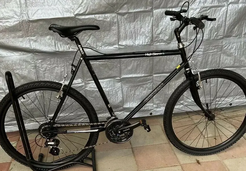

I started a post ages ago about my Schwinn High Sierra find but life got in the way and the project got shelved. Anyway, fast forward to now and I've dragged it out of the shed for another look.
My very basic question is, generally speaking, is it possible to replace older components with newer ones to keep the vintage look and feel of the old High Sierra frame? I believe I have the Deore Biopace set on mine and the shifters are rusted out / broken, so I'm looking to modernise. I will keep the roller cam brakes because I love the look of them but otherwise a new seat / post, bars etc are all fair game.
Any advice on this plan of action, for a total newbie?
