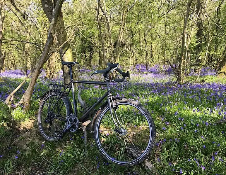

Should work well. You could argue that plenty of 26” drop bar tourers (e.g Roberts Roughstuff) are similar things, and would certainly cope with some gravel.
They are not cheap but I’ve got some excellent Compass Natches Pass Rat Trap tyres on this 26” Roberts. 1.8” but there is a Rat Trap from the same company in 2.3”
