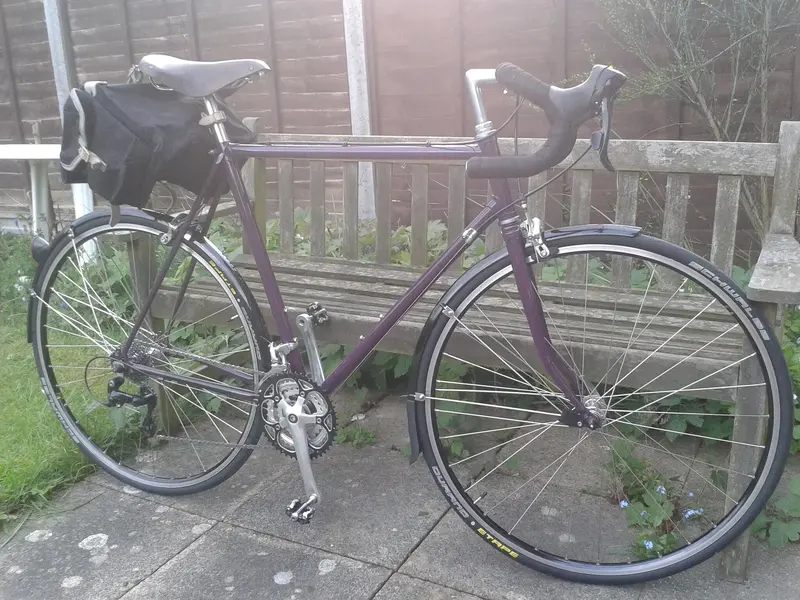

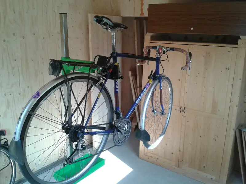

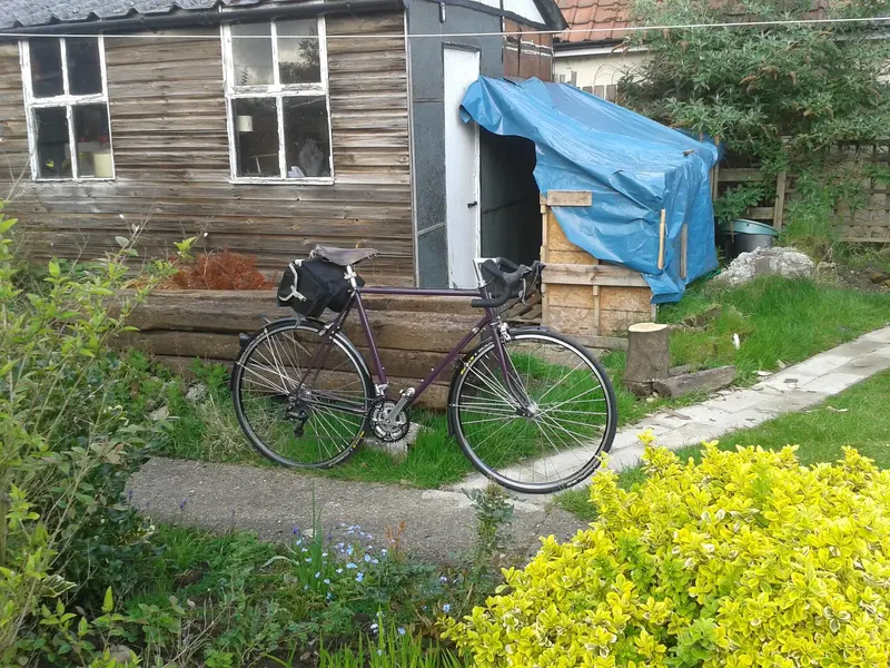

It's a brand that I'd never heard of: a 'Target Road Ace' made in Barton Upon Humber, so I'm guessing it has Falcon origins of some sort and I'm guessing built in late 1980s? I haven't got any photos of when I picked it up, but it was fitted with a flat handlebar. Very quickly I fitted drop bars to it (and some garish tape). Here's one of the only photos I have of it in this condition:

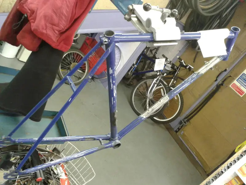

Even though the frame is just gas pipe, because it belonged to my late FiL, I wanted to keep it as a winter bike. But first it needed some modifications:
Frame modifications and first post renovation riding:
Water bottle bosses and downtube shifter mounts:

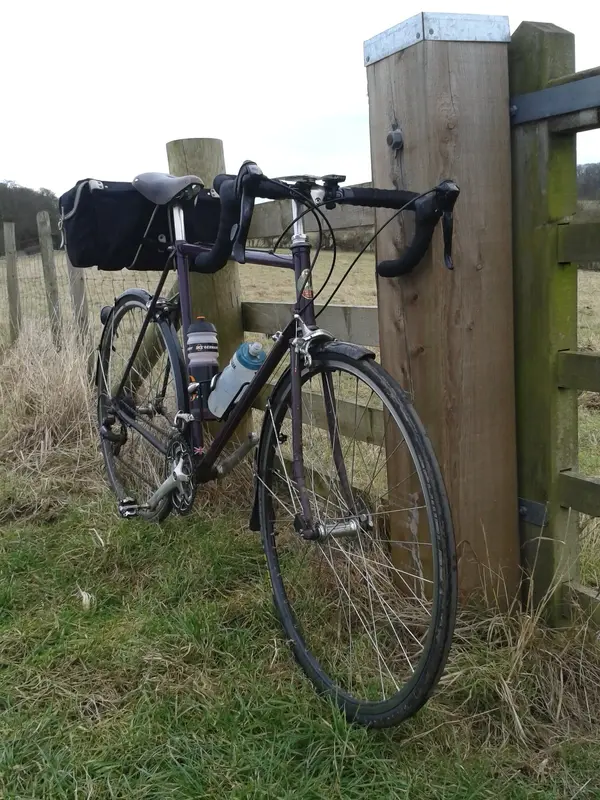

It worked well as a winter bike but it wasn't long before the urge to modify/add decals appeared...

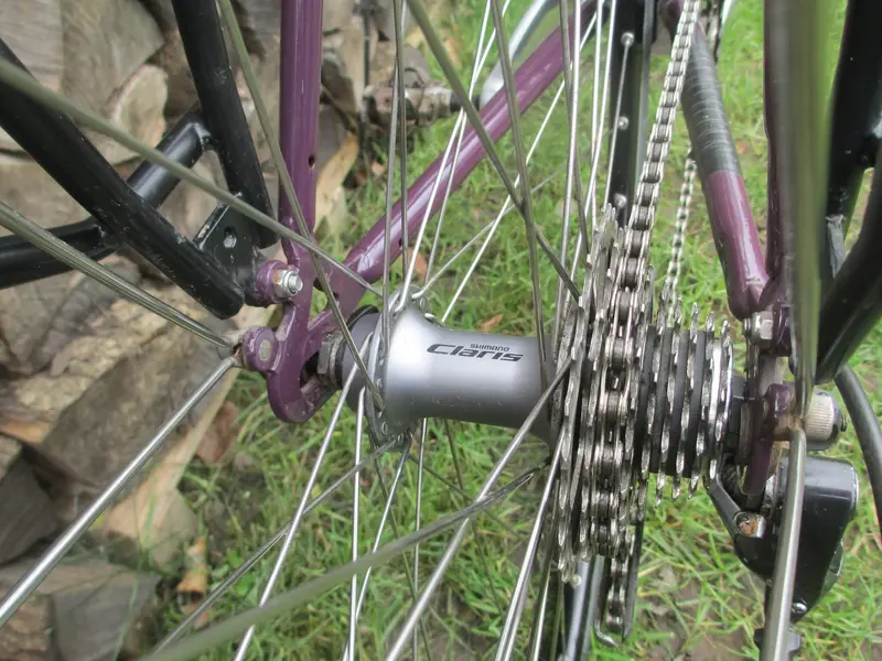

As built, I'd fitted it with Sora 9x3 shifters, a Soma Highway One bar, Spa Cycles crankset, a Brooks B17 saddle, Sora rear hub, 105 front with Rigida Chrina rims.

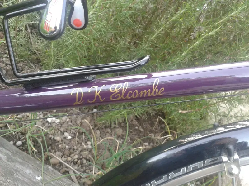

I then had my late FiL's name applied to the bike:

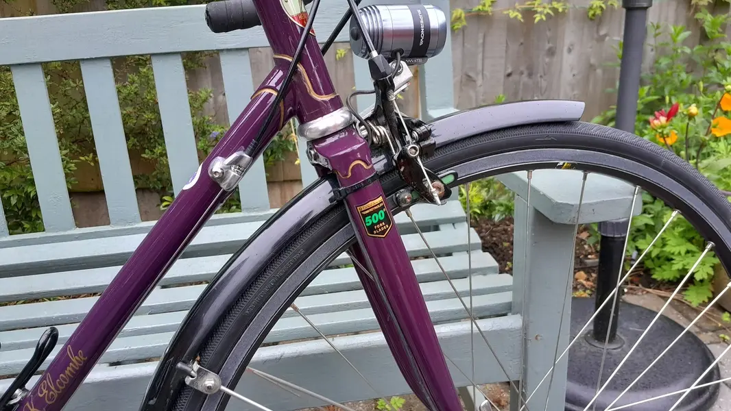

A few years passed and bits wore out. At this stage, I also added a rear rack and swapped to a Spa Cycles Nidd Saddle. I also wanted to fit the lowest Reynolds decal I could find - so I went with Reynolds 500. Mis-badging, but hopefully not too bad...

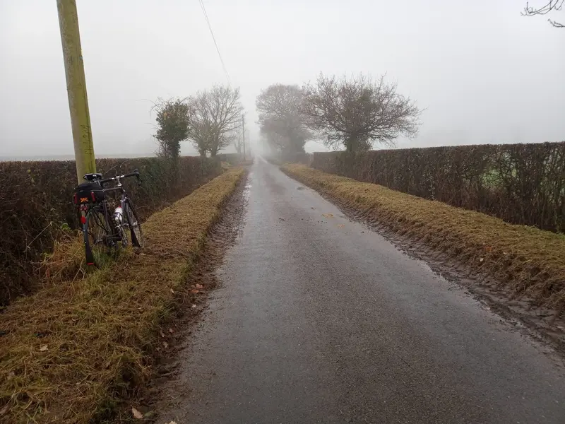

More winter riding

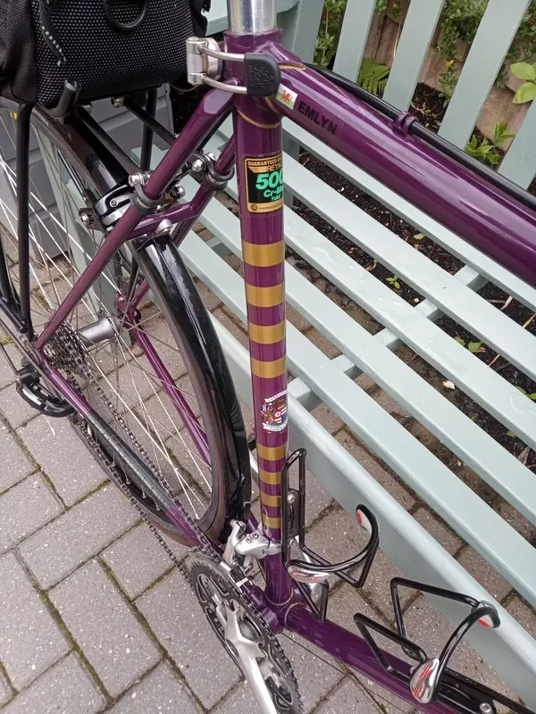

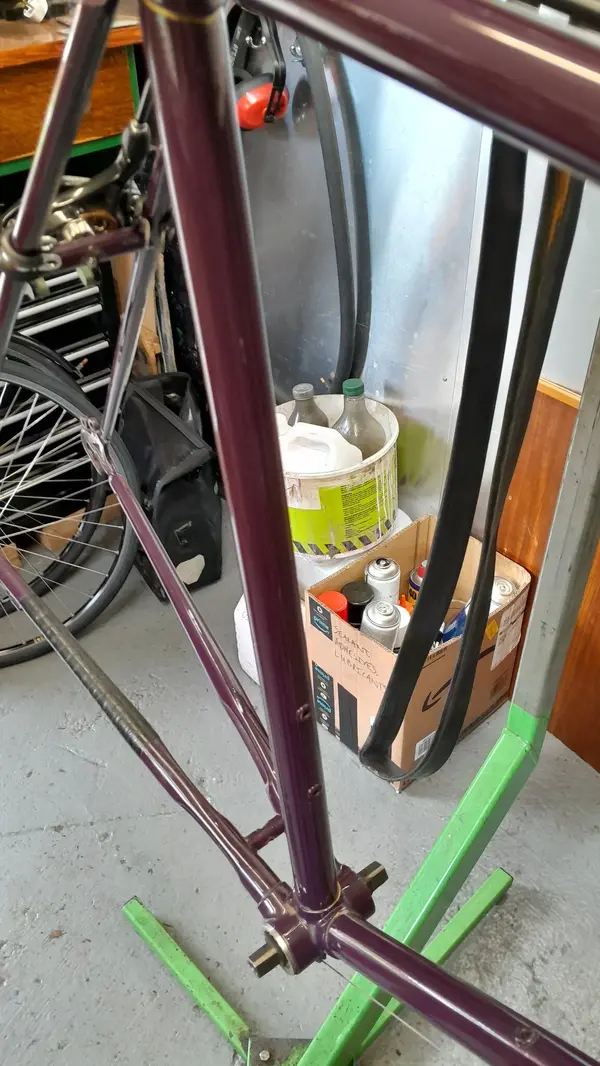

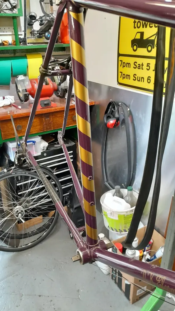

The gold bands had started peeling off, so I removed them

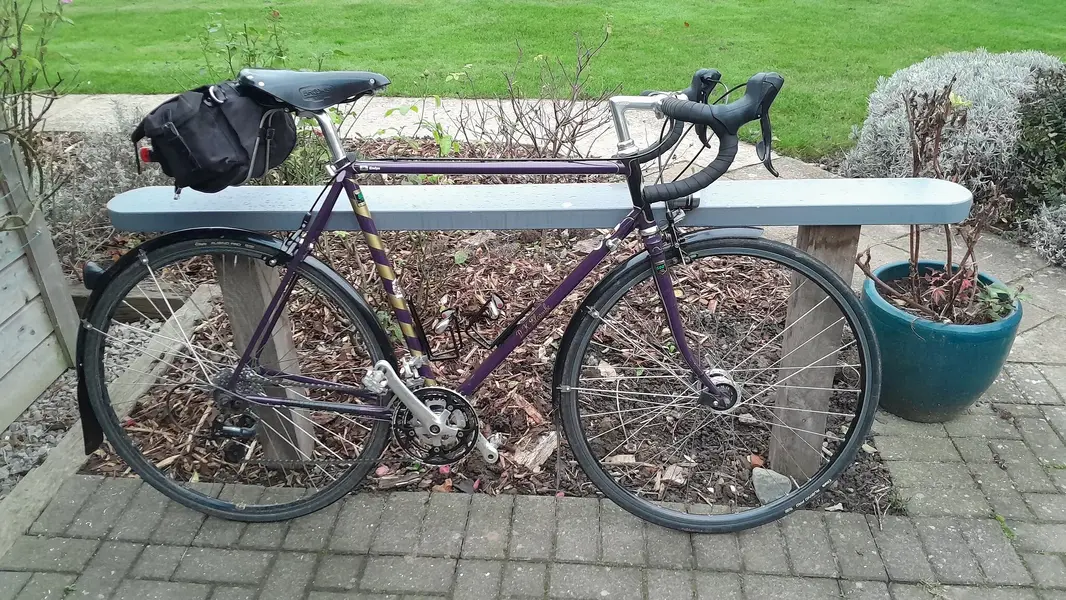

And replaced with a barber pole. It took a few attempts to get it right, but I'm pleased with the final result.
Assembled and with other decals applied.
I also took the opportunity to add some more decals.
Black head tube also added.

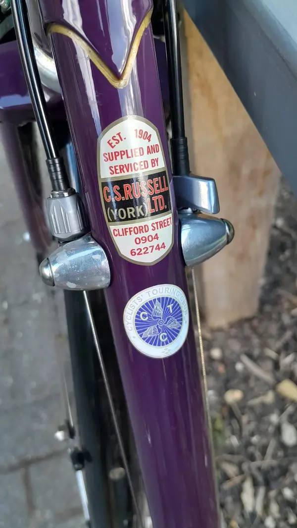

and H Lloyd Cycles created an old York bike shop decal for me.
I suppose I should cover how it rides etc. It's not light - 13.5kg or around that sort of weight. But winter riding is slow anyway. It's comfortable and the components are all chosen to deal with the winter grime/salt. I guess I've done around 8k miles on it by now over the years, but I've ditched my cycle computer as I rather ride without knowing I'm slower each year that passes. The Spa Nidd Saddle turned out to be too uncomfortable for me, so I swapped it out for another B17.

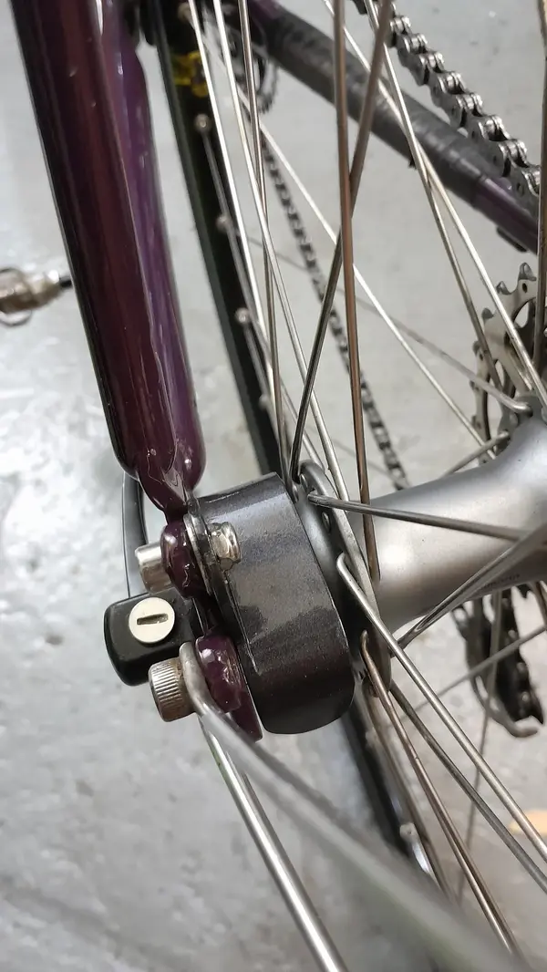

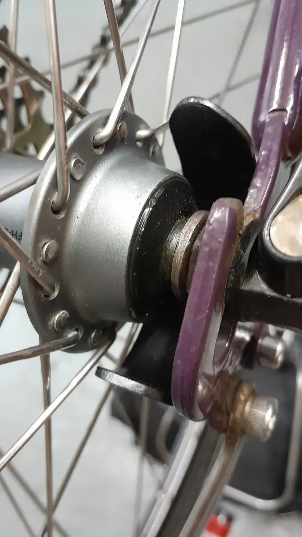

As it's a winter bike, it gets wet more often than not. I noticed that water would often be drawn into the rear hub via the non-drive lip-seal, turning the grease into a mayonnaise.
This year I decided to try and improve it, so after some experimentation, I created a little cover from some spare aluminum to stop water from (I think) the brake caliper from being drawn into the seal.
View from below.
Seems to have helped. It might mot have stopped it completely, but it has reduced the problem a fair amount.

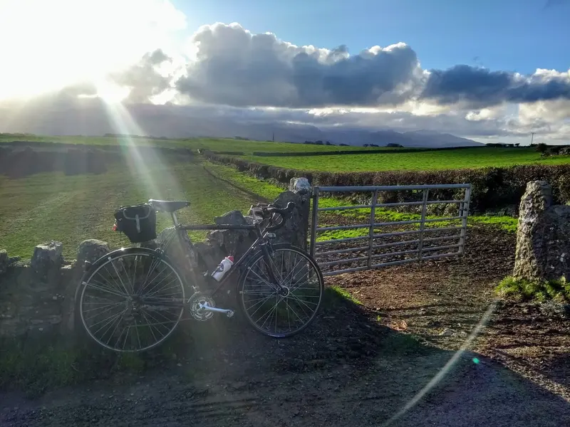

Which leads to it's current state. Pannier rack removed, a smaller Carradice Barley fitted and still racking up the winter miles.

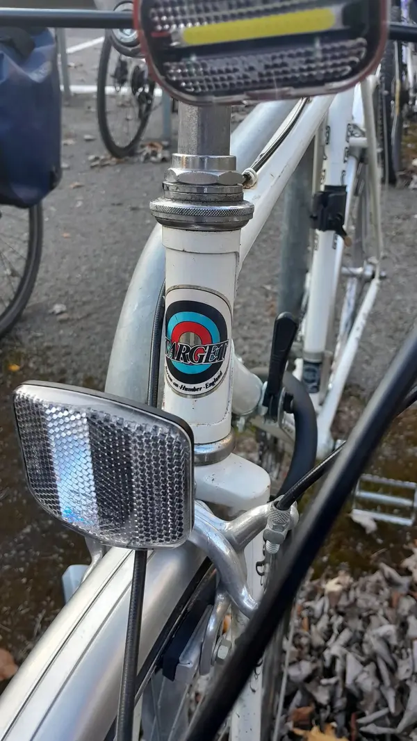

I have researched Target Road Ace, but found nothing online. I had never seen another one, then by chance I was walking by a bike stand the other day and what did I see? A Target Road Ace...
If anyone knows anything about these, please let me know. As I've already mentioned, I'm guessing they were a sub-brand of Falcon as the head tube badge says Barton-on-Humber. The lack of braze on fittings is apparently also a signature of Falcon.
But if anyone knows better, please let me know!
