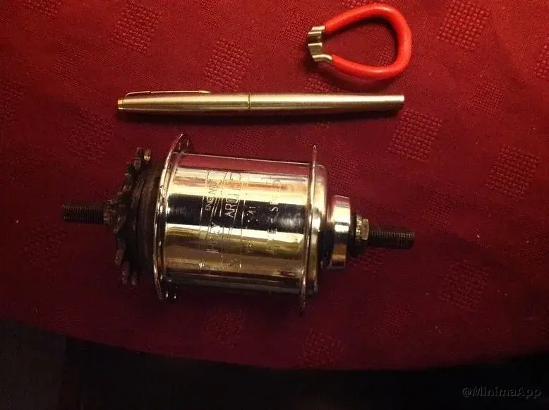

Evening Peeps. As you know I am saving a scrap Moulton and have now dismantled the rear wheel and will have a go at my first full wheel build in the next day or two. The hub has now been cleaned inside and out and has the following text engraved on to it:
Sturmey Archer England
S5 68.
FIVE SPEED
I believe the 68 refers to the year? The five speed should be self explanatory, but I thought it was a 3 speed? Certainly the shifter only has 3 gears.
Any ideas?

Is it possible that a 3 speed like an AW internal has been fitted.
My experience with SA was a little before the 5 speed, but I thought I could remember 2 controls. The hub shell could be the same, the 4 speeds always had 5 gear ratios in them, with 2 trains of epicyclics.

S5 is definitely a 5 speed shell. and 68 was, I think, the first year that 5-speeds were introduced. It may be that someone at a later date discarded the internals and substituted AW internal. It would fit. No need to dismantle the hub. The 5-speed had a full hollow axle, the AW was only hollow from the gear side to the middle, with a very shallow indent on the nearside. If you cannot insert a fine rod (old spoke, size 0 phillips screwdriver etc) then it is AW. One other possibility is that the internal is a 5, and the LH toggle chain is missing, in which case it will be medium-wide 3-speed 26% increase and 21% decrease.
