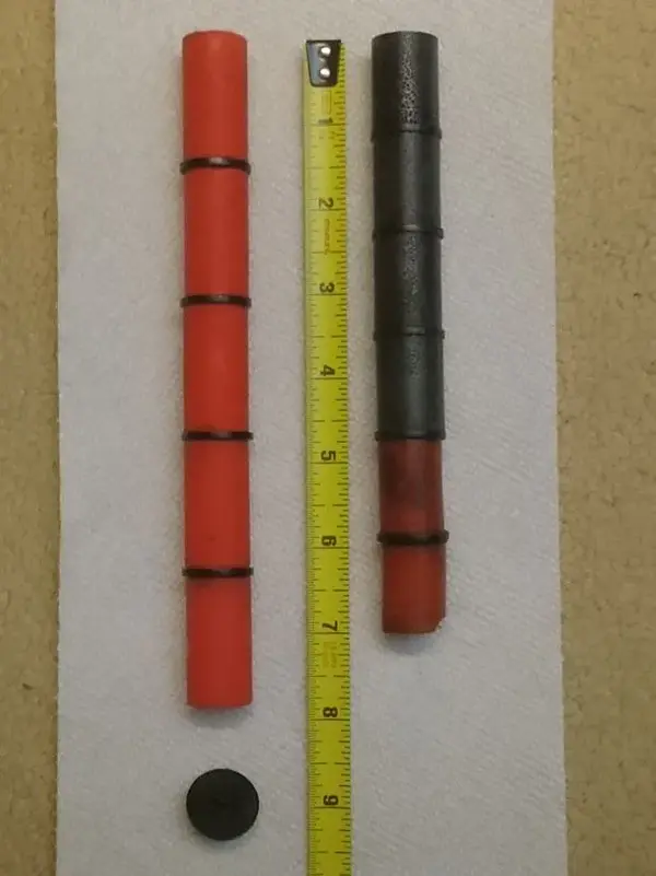

Wow, your replacement elastomers/MCUs feel pretty damn good. I think they're BETTER than the crappy original that came with the fork. I don't remember my '95 Judy XC feeling this good. No joke. Either I did a good job cleaning/rebuilding my fork and changing the oil in the cartridge ;) , OR, your replacement elastomers feel excellent. Or both. :cool: :LOL:
By the way, I used all 10 elastomers you sent me, without cutting any. My original MCU stack (my only good leg) measures 7 inches (178mm) - 6 blocks with 5 spacers/jax. This equals to 4.5 blocks of your replacement elastomers per leg, BUT...I didn't want to cut the 5th one in half. I decided to used all 5 blocks per leg. No problem at all. Actually, it feels great. Nice and plush. Better than the crappy original MCUs....in my opinion.
Thanks for the awesome elastomer replacement.
-J
ps. I wrote a quick positive buyer feedback for your Retrobike seller section....and also because a good product deserves an occasional shout-out ;)
Pictures for those people still on the borderline. Original Rock Shox MCUs on the RIGHT, rva's replacement on the LEFT. Instead of cutting the 5th block in half to match the original stack length, I decided to use all 5 per leg. This is what it looks like with all 5 inside the upper tubes:
As you can see, the top block (red) peeks out a bit over the fork crown/upper tube, ~ 2+ mm. Now you're wondering about the top cap? No worries because when I screw on that plastic preload adjuster knob/thingie, I adjusted the dial to zero (full counter-clockwise), push down on the elastomers until the threads meet, then I screw on that adjuster knob/cap to the upper tube, both sides. Not hard at all.
Fork feels great to me. And the preload adjuster dials still work.

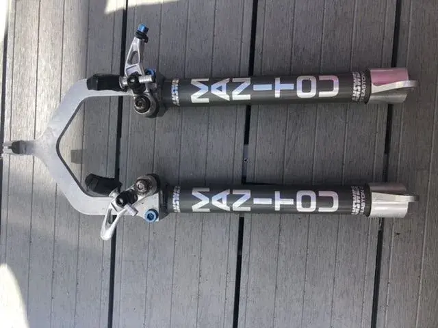

Hi,
I’ve had a set of these on my Giant cadex 1 since about ‘95. Just trying to revive them and need new elastomers. Looks like they have 1 rebound, a small and large compression elastomer in each fork? I’ve not used the bike for some time and not an expert but was wondering if you provide replacements for these elastomers?
Thanks
