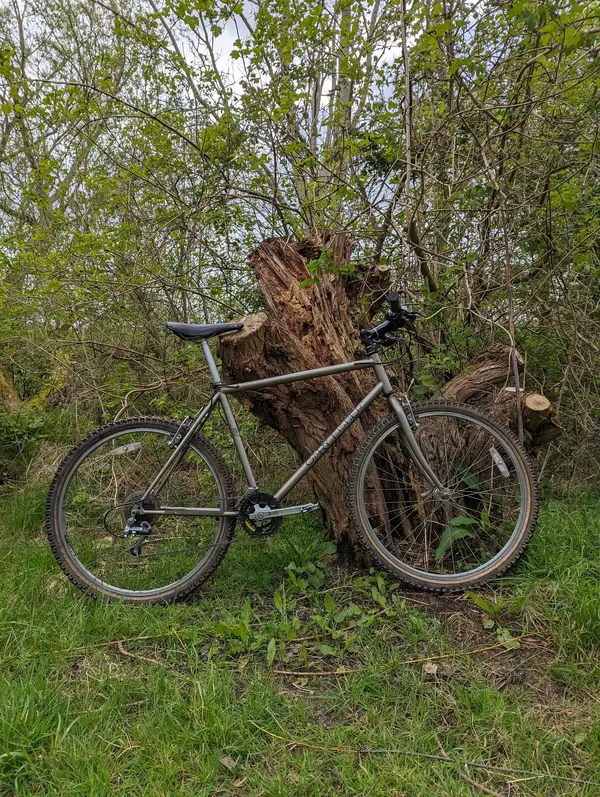

Can anyone give me any advice on the bottom brackets. There's the tiniest bit of play, like maybe 0.25mm. Is this anything to worry about or an easy fix?

what year is your GF ?
until beginning of nineties, they used « press fit » BB (like Klein). In that case, you should change the bearings
1989. How easy is to change the bearings?
2 possibilities :
• Firstly, you’re the lucky owner of the Klein remover BB tool (picture)
• Secondly : you aren’t the Klein tool owner. So, you need a good hammer and screw a crank bolt on the top of the axle for protecting it. Don’t forget to grease for helping the integration of new bearing
