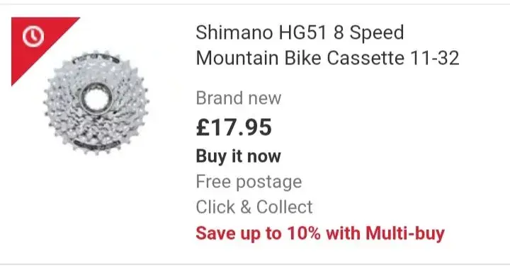

Do you mean something like an HG51?...
If you insist on new old stock, keep searching but
Sometimes you just have move forward.
Me, I use these below. Coated, drilled and affordable.
Not heavy either. The apparent mid- table model name means
Nothing, they feel quality in hand.

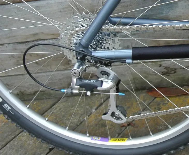

I don´t use the new Shimano because the 8 speed casettes have a "megarange" or something like that, a big pinion in the last position. I have choose the Sram 850, it is not the low range (830 are cheaper) and looks quite nice.
Chains the same, new ones. In the photo the 11-32 sram.
