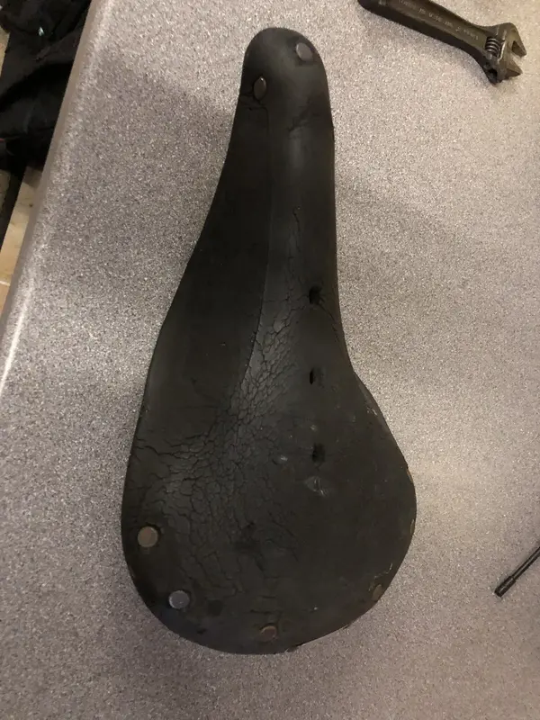

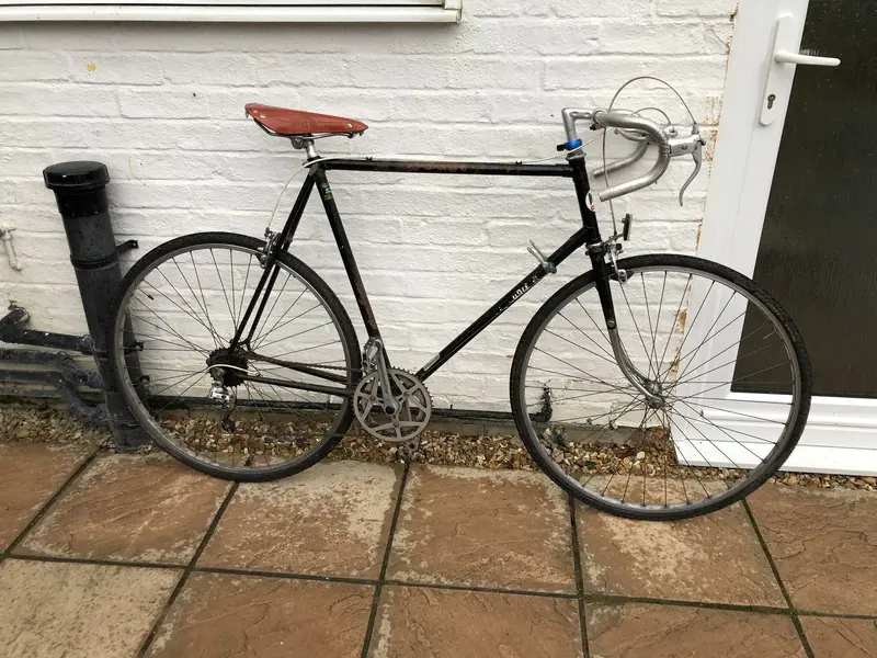

2B59A43D-D5D6-4E7F-8872-E8C89F463B4D.jpegE0295077-A31E-45BD-90EA-23B9DFA0B8CA.jpegI scooped this with a ridiculously low eBay bid - collected last night. Bonus - it’s got 531 tubes and a scruffy but not wrecked Brooks B17 saddle. I plan on keeping the awesome rusty patina and building it as a bullhorn bar single speed. I’m going to polish the wheels and components to contrast the scruffy frame - should look sweet.
Any info on model or age would be cool, thanks.

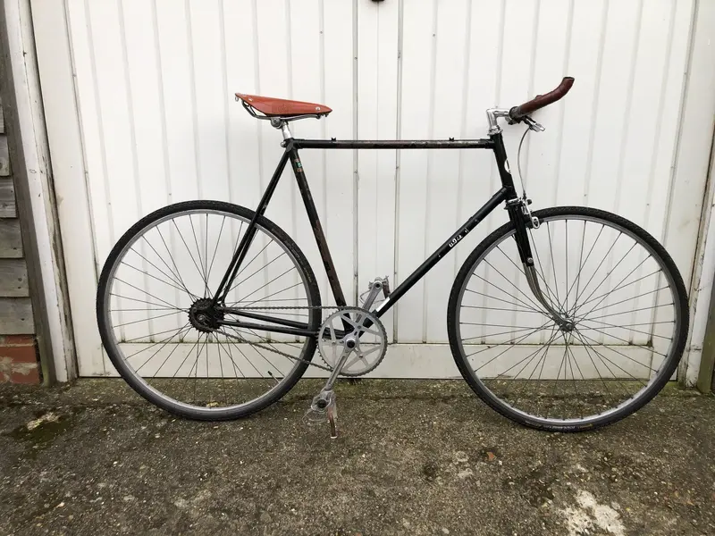

0F4C4264-D0D5-427A-9E1F-4D6217CACC38.jpegMaking progress already, wheels need more polish but the frame rubbed down with steel wool and then a coat of wax - looking sweet.
sparkybhp
Pretty much there now, fitted just a front brake as space is tight at the handlebars - had to drill out the clamp to 25mm to get it tight up against the stem. That was a mission - even with a starret hole saw in my pillar drill, it kept binding up (being aluminium) and got damn hot too..
It rides nice, the gearing is very tall but makes a nice cruiser and is light for such a large frame.
