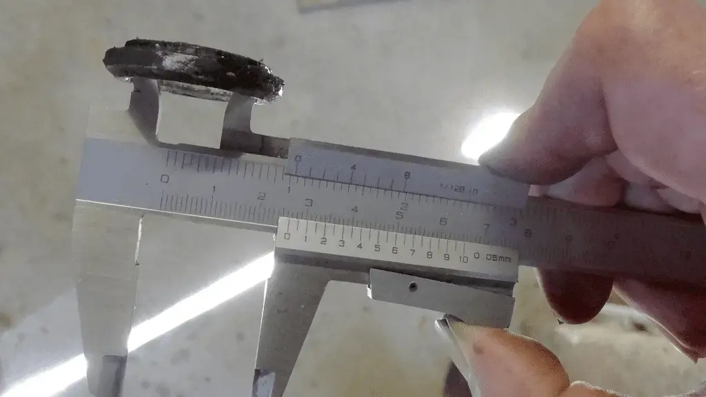

Remembered I pulled the headset off a late 40s Pug Randonneur and wondered if it could be of use to you. Was even surprised at myself I was organised and could find it. Wasn't that surprised that I hadn't been arsed to clean it.
Sadly not suitable. Crown race is that "other" obsolete French standard 26.5, and not 27.0 😞
A very quirky design and looking rustic but serviceable. Stack height came to about 35mm (12 + ~ 23) if it helps any.
